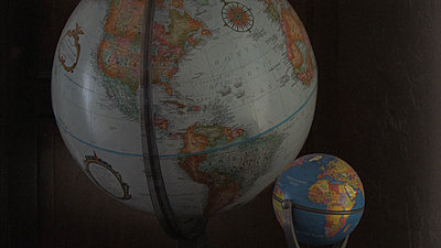

This XHA1 camera is designed for the ENG market, I think. Newspapers will buy these by the hundreds for web video because they're a thousand bucks cheaper than the Z1U. Churches will buy the G1's by the hundreds because they're a tenth of the price of a broadcast camera. Same for cable stations. Networks will use them in place of their PD170's. And wedding photogs need high-def and low light.
So low-light performance is really important. I've been comparing the Sony Z1U to the Canon XHA1 in low to no-light conditions.
First, to you wedding guys, this still isn't a PD170 or a 2100. Sorry.
However, it does give you about a stop more light at 12db than the Z1U at 18db, I think. However, both cameras are so customizable it's hard to say yet. You can set the canon to 18db and 36db but I haven't tried it yet.
Here's a frame grab from the Canon at 12db of gain, 1/60th 2.8, with black stretch on and nr1 and nr2 both set to medium.
I think it's pretty amazing -- very low noise.
Chuck
(frame grab from fcp, de-interlaced in photoshop and resized for aspect ratio but otherwise untouched)

That does look nice. To emphasize the noise, would be interesting to see a spot(s) of light somewhere, an incandescent light, candle, street light etc. Inbetween the areas of contrast, to light up the grain, make what's hidden in the dark visible.

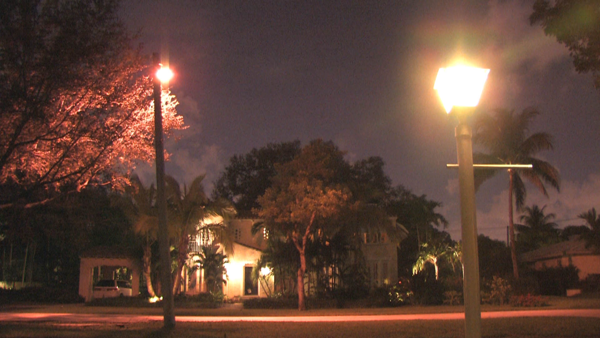

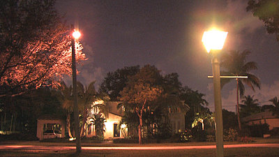

Here's a frame grab from the XHA1 at 18db gain, black stretch and noise reduction on. Note that you have to go into the menus to get 18db; max gain is normally 12db.
To the naked eye, trees and grass are featureless black, sky is completely dark.
(I also tried it at 36db gain. It's very noisy but would be useable for news. It's way better than the Sony Z1U "hypergain" setting, but still really nasty, with muted colors.)
I'm on a mac, so the gamma might be off for some of you. Seen on component out to an HD monitor from the camera, it's bright and open.

You can see grain but it looks more like film grain than video noise.
