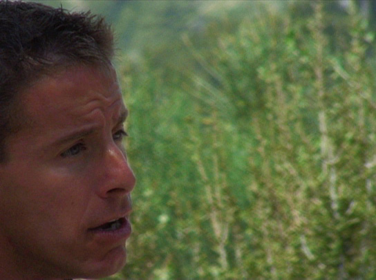

I've attached an image. You'll need to open it to full size to see the noise.
If you look at the trees in the background you see a kind of patina over the out-of-focus parts of the image. It looks almost like it was shot through a bug screen (it wasn't - that's clear air between the camera and the background).
I remember reading somewhere what caused this - and I seem to recall the suggestion that the lens was too good for the camera (the pattern you are seeing is something to do with the sensor array)... but I may be recalling that wrong.
Anyway, however it's created, it's there.

Thanks, Alex, for that illustration. Very clear distortion of the background, indeed. It is very similar to image processing induced artefacts I've seen in highly compressed airborne surveillance images. I would place a little bet on the compression after all.
However, what's interesting is, as you say, it's there! So this is a typical HVR-A1/HC1 behaviour that is not seen with the Canon XH A1? Then Canon scores one more point with me...

Originally Posted by Alex Leith
I've used the Sony HVR-A1 / HC1. I love the size, and the images are generally excellent - but there were two problems we noticed:
1. Low light performance is rubbish, and the image quality rapidly degrades and colour balance dramatically shifts when things get a bit dull.
2. Out of focus objects display a sort of moire patterning. Apparently this is something to do with the lens resolving more than sensor can cope with?
The screen door effect is the bayer filter. My Canon HV10 does this. My JVC GR-HD1 did this. It's what you avoid when you get 3CCD/3CMOS as opposed to the one chippers. The 3 chippers don't need this filter, the single chippers do to produce color.
You'll avoid this moire pattern with any 3 chip camcorder, Sony, Canon, Panasonic, JVC et al
Tom Roper is offline   Reply
