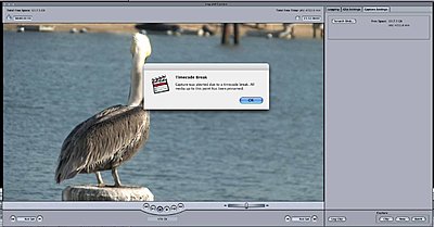

Hi Chris thanks for the help..
I got this far but now its stopping after every timecode break.. any sugguestions?
I have already un-checked "create new clip on Start/Stop"
Shouldn't that have fixed this? I want the tape to run all the way through without stoping..
