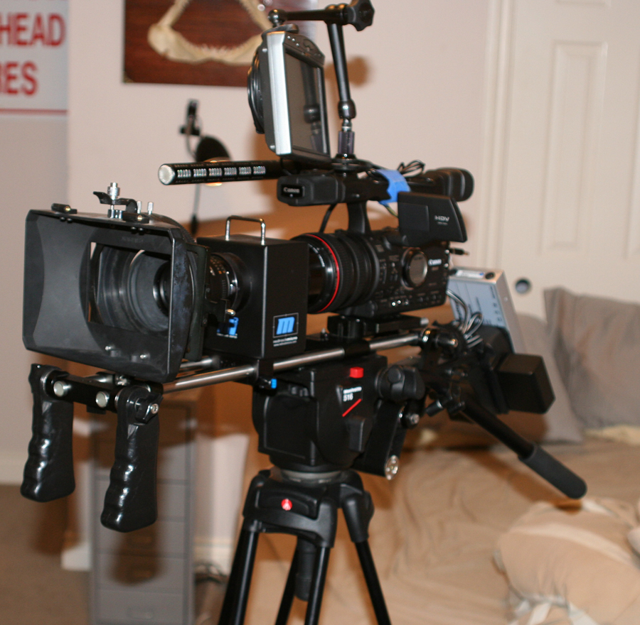

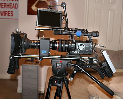

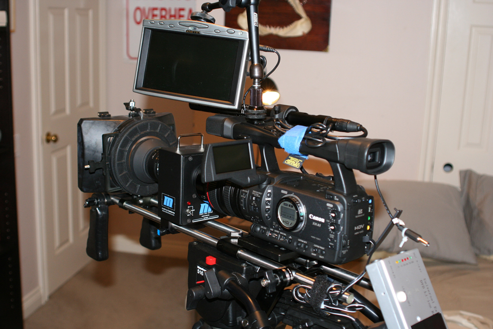

Finally... my XHA1 and Redrock M2 rig...
Anyone here of any huge problems using GG adapters and HDV? I heard there are some grain issues... anyone got any fixes?
Have a look at some of the pix.
Anyhoo... enjoy... will get some footage up tommorow..
Matt
The worst part is, I got it about 4 hours ago, and I havent even shot anything with it yet... jsut couldn't resist.

OKay, first testing note... the motor mount must be all the way at the bottom or else its visibile in the M2... the XHA1 can BARELY zoom in and keep focus... its pretty much the zoom hits the right angle of view, it snaps into focus, and a mm further and you lose everything, so its critical to be zoomed in jsut enogh
will come up with a number soon

Okay, so, It seems at 68 I can get the Ground Glass in Focus, but I am still getting vignietting cause I can't zoom in quite far enough and retain focus...
Any ideas?
EDIT: Sorry chris, didn't read your post...
It seems around 70 is the magic number. However, I am getting some vignietting and I want to get the zoom to about 75 while still being able to focus... would a spacer tube acieve this? I am a little rusty on my Optics Knowledge...

Cant post anything yet to due to hardware needing upgrade (processor!) webspace down and being incredibly busy, but here are some purely subjective things I have noticed using the A1, M2 combo
(Watched on colour-corrected 42" Sony Bravia with SXRD via component cables)
-Colour saturation is diminshed by maybe 5-10% via the adapter. This can be compensated for by boosting the colour gain in camera.
-Resolution seems degraded by about 5% (estimate) but this is also using Canon's 24F which apparently degrades res by nearly %30 (correct me if these #'s are wrong please!). However, Subjectivly, I think the 24F looks just as good as the 60i resolution wise, and for motion characteristic and strobing, it is identical to the DVX 100 and XL2... looks great!
-Grain: In a well lit situation, I didnt notice any extra grain, with gain settings on 0. The glass spins fast enough so that the HD doesn't pick it up. I heard some Vibrating adapters have issues with it, but the M2 seems to work jsut fine.
-Low light: The camera itself is a beauty in low light. Colours don't get muddy, and it exposes well. With the adapter, the lowlight drops by about 2 stops (using a 50mm 1.8 lens), so you need to compensate by adding more light (in a cinematic environment) or boosting the gain. I find that using 6db of gain is a good tradeoff between exposure and grain, or opening up the shutter to 1/24 of a second.
An interesting note, is due to the optics of this lens, I cannot quite zoom in far enoguh to remove 100% of the vignietting while still keeping focus. I don't know if a spacer tube is the answer, maybe someone can tell me. Also, the amount of zoom (69% according to the camera) gives the internal iris an f stop of 2.4, therefore, you lose even more light. I wouldn';t really use any lenses slower than 1.8, and for my next film, I am using only 1.4's
I am happy with the combo so far, but want to eliminate the vignietting (image circle isn't quite big enough) and play with the custom presets to help reduce nosie in the gain settings...
