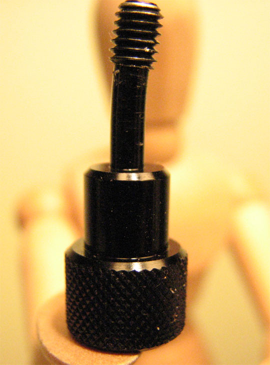

I'm a little embarrassed that after starting this thread last November I sent my A1 to the Canon Factory Service Center (in Irvine, CA) for repair last week. (The factory warranty was about to run out). It came back yesterday (they received it on a Thursday and shipped it out the following Tuesday).

After unpacking the camera the first thing I did was try to load a cassette with the power dial in the A position. After that failed a few times I tried the VCR/Play position which worked only the second time out of four attempts. The problem was not fixed, and probably was not understood by the repair person. I would have gladly explained it again if they had contacted me but they didn't.
I don't know why they replaced the mic holder since it worked fine before. I use it sometimes. The shaft of the bolt in the new holder is bent as shown in the attached photo. When tightening it the head swings around nearly hitting the holder. It's awkward. I never appreciated how straight the old one was.
The firmware update fixed the -40 in Custom Presets bug but unfortunately all of my custom presets got erased so I'll have to set those again.
On balance, sending it in seemed to result in a minor net loss. I'm not sure I want to try again. (Never had this problem with Mack warranty service for a GL2).

I decided ask Canon to replace the bolt (thumb screw) so I called Customer Service and explained what happened. They sent me to the Parts Department but Parts said they only sell parts (they don't comp them) and sent me back to Customer Service. Then I got this first-rate-sounding customer support person, Chris Canada, who said he'd take care of sending it out himself. (Actually he's going to send out the whole mic holder assembly since the thumb screw does not come separately). I'll be glad when that arrives.
Am still planning to send the unit to Mack to fix the original 'Remove the Cassette' problem.
