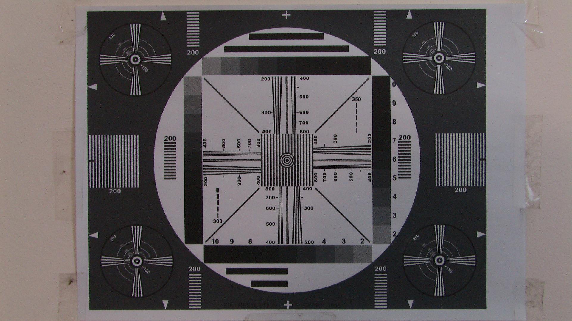

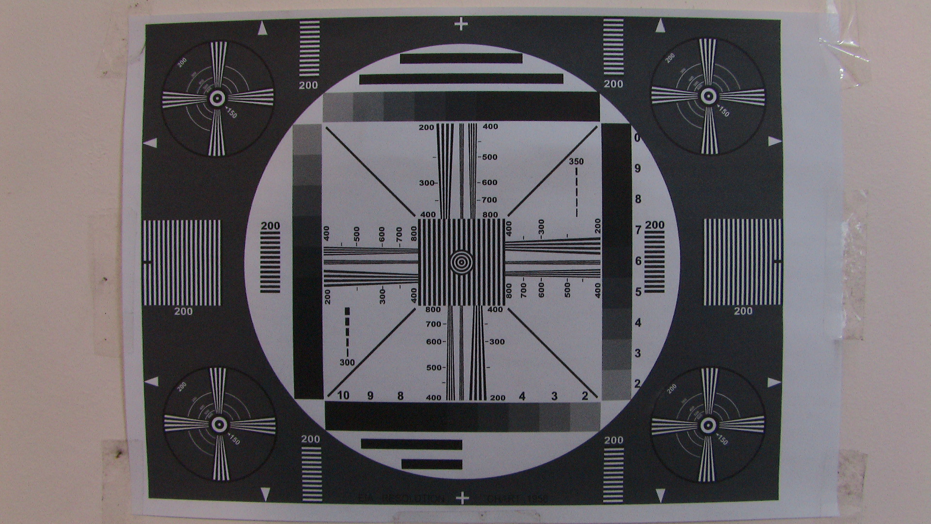

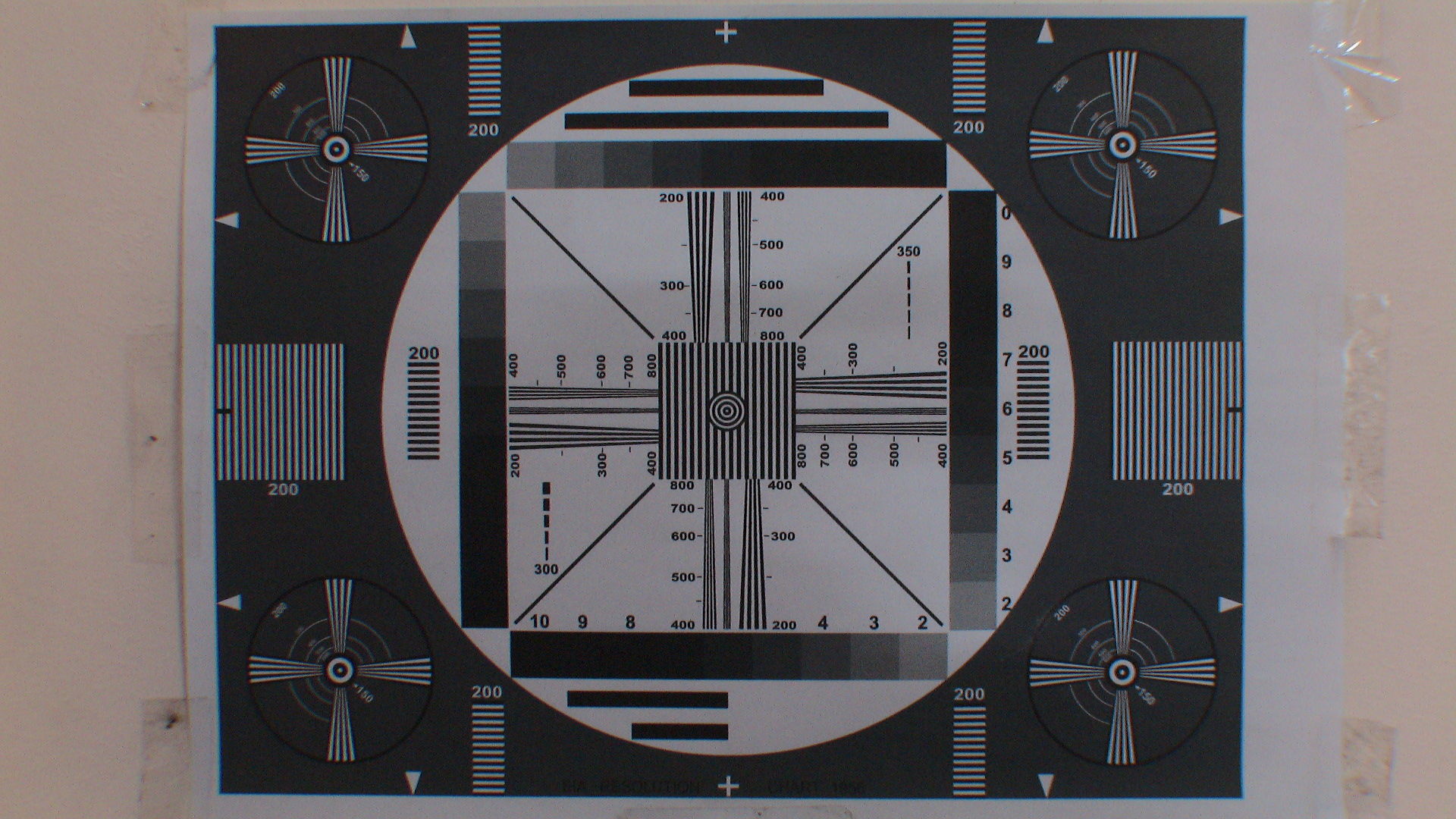

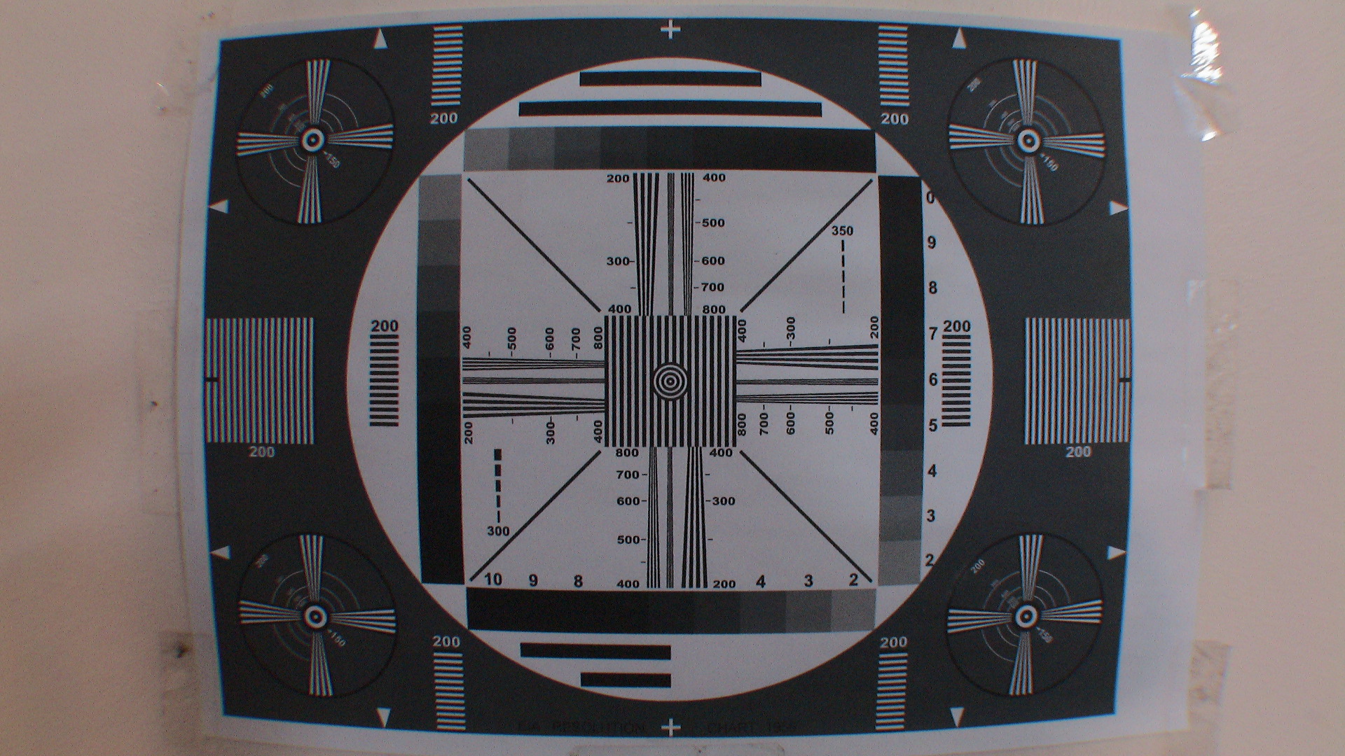

John, I did some stillshots with and without the CO 0.7X WA Adapter. I was actually trying to check out the keystone distortion in my sample clip, but thought I'd include the WA for comparison purposes since you mentioned it.
I took 2 shots at full wide angle with and without the adapter fitted, and also at a not so wide angle obtained by turning the zoom ring 3 notches. Don't know what the exact setting was, but I made sure to not disturb it while I removed the adapter.
Here's a couple of comments from what I see in these pictures. Others are free to chime in.
First, the distortion in the basic lens is barrel distortion, and is not bad considering how wide it goes. the keystoning of the original sample clip could be due mainly to the composition of the shot as I was well below the cable car tower and peering up at an angle.
Second, by zooming in slightly, i.e. not using the full wide angle the lens is capable of, the barrel distortion reduces very quickly.
Finally, the WA Adapter, although it increases the barrel distortion and has obvious CA, does not drop as much resolution as you might expect from an SD lens. I consider the modification to make it fit on the XH-A1 to be time well spent and will be happy to keep on using it where necessary.
Richard

Richard
Thise were very revealing shots. Backing off the full wide does seem to make a significant difference in the distortion. I shoot product stuff (stills) and I am making the transition to video as part of what I will offer. So this kind of detail helps me. Thanks

Hi John. I should really have mentioned it before. Just in case it's not obvious to everybody, when I adjusted the zoom I moved the tripod to compensate, to get roughly the same framing. That's why the image size isn't changing much.
