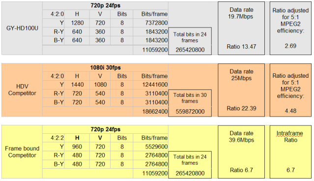

JVC says:
Compressing progressive signals is more efficient than compressing interlace signals. At any given compression ratio, progressive images can be reconstructed more faithfully and with fewer artifacts. That's one reason all high end digital cinematography systems utilize progressive scan.
The following table compares the relative amount of compression in JVC's GY-HD100U with that used by competing systems. These numbers represent data rates, not actual picture quality. Typically, in systems that are less efficient (i.e. frame bound or interlace) manufacturers have reduced the resolution in the image so that the DCT compression works more efficiently.
So, even at 24 frames a second for both, 1440x1080 would have 69% more pixels than 1280x720. Using 25Mb/sec and 19.7Mb/sec respectively, that is 33% more compression. If using 30frames/sec with 3:2 pulldown, it becomes 66% more compression. Then JVC says that progressive frames compress better.
So, in practice...since we are only comparing 3 cameras (HD110, A1, and V1) and their immediate relatives (HD200/250, G1/H1, FX7) how does this affect the image? And of course, this begs the image, how much does capturing HD-SDI or HDMI output help? If the HDV compression hurts Sony the most, presumably capturing the HDMI would help it the most.
David
David Ziegelheim is offline   Reply With Quote

What you're failing to realize is that the compression is not affecting the image nearly as much as a wide variety of other factors including the quality of optics, the efficiency of the DSP, etc.
Why are you obsessing over numbers? If you want to know how compression affects the image, simply look at the image on an HDTV display. There are enough downloadable sample clips available on this site and others which prove that it's pointless to get hung up on this stuff.
The chart you've included from JVC's marketing material is excellent fodder for measurebators, but carries no siginificant impact for the majority of folks whose prime motivation is to actually *use* this gear in a productive way.

No, not numbers, but the quality impact.
I believe all of these cameras both allow recoding of input that bypasses the camera section and allow output that bypasses the tape recording section. So the question, since these cameras seem to have much more significant differences in their recording than in their capture or processing, how does the recording impact quality.
MPEG is pretty well known, and I believe there are some people around here who are relative experts on it, I thought we could identify its impact on the result.
