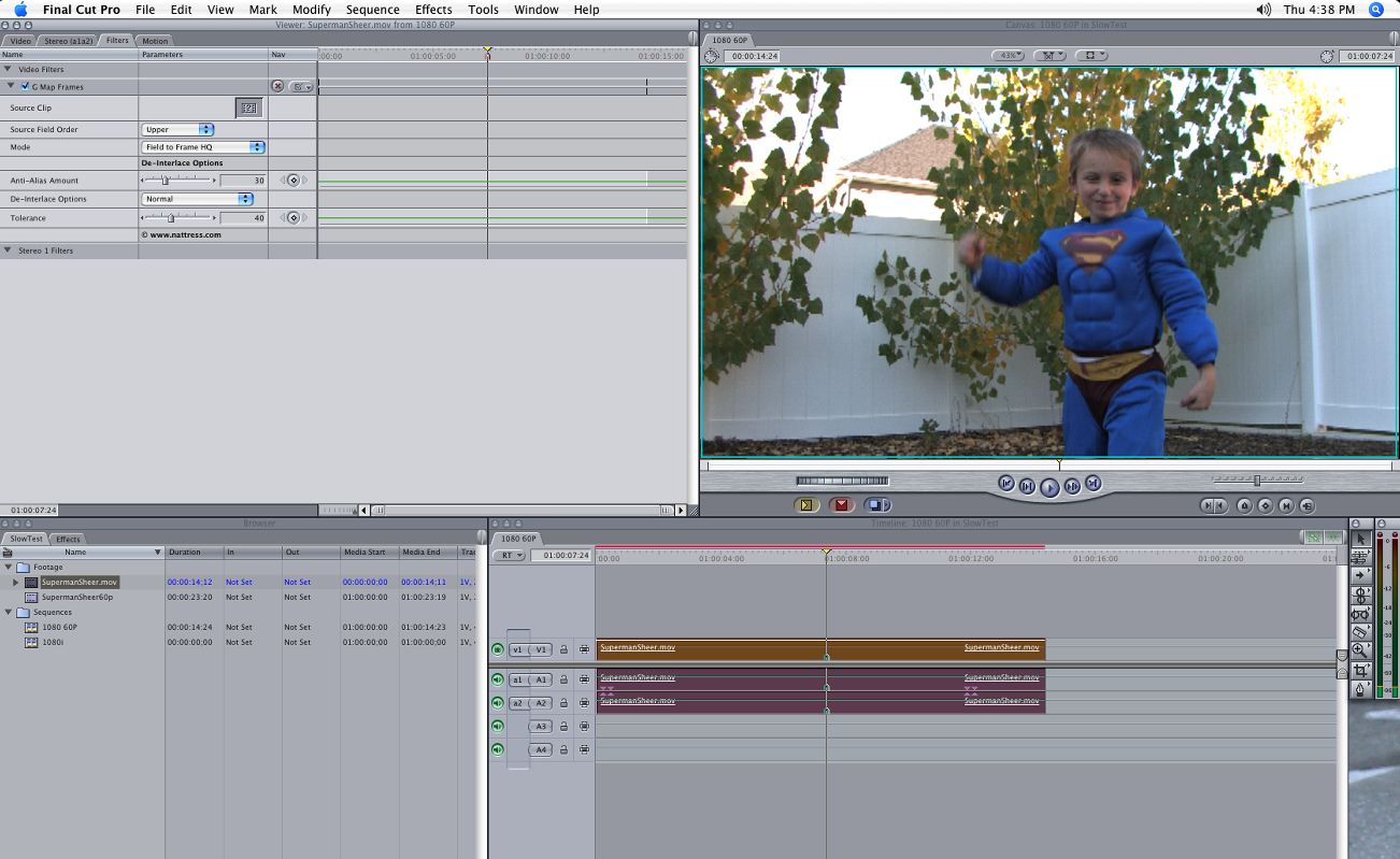

Here's how I do it in FCP:
--Drop a 1080i clip into a custom uncompressed 1080 60p (seriously!) sequence.
--Apply Nattress Standards Conversion Filter
--Select "Map Frames" and then choose "Fields to Frames HQ"
--You'll be prompted to drop the original clip from the bin into the image well of the filters tab
The interface should look like this attachment:
Export the clip as a self-contained QT movie, bring it into Cinema Tools and conform the frame rate to 23.98 (from 1080 60p) and then scale and recompress to whatever codec you're editing in.
Barlow Elton is offline   Reply
