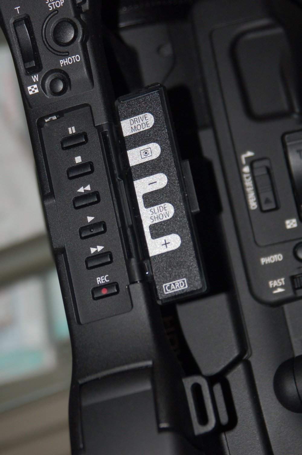

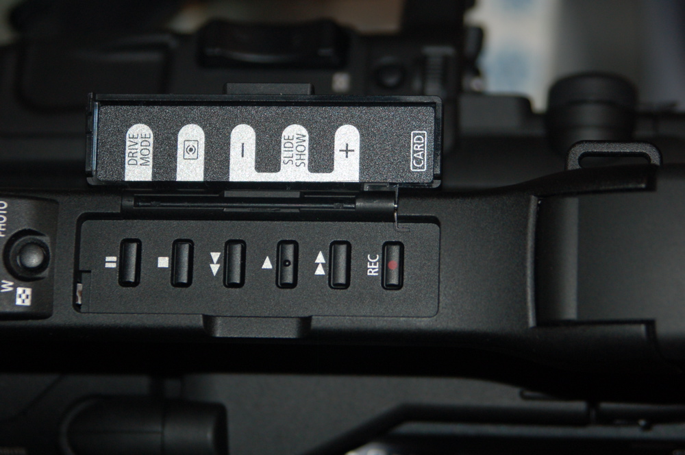

Pics
Hope these help. I do not see anything other than the 2 pins and a spring that goes from the body to the flap.

Thanks Josh; but as far as I can tell from your pics, there IS a pin at the back, where the spring comes? It must have fallen off and got lost! Is it a metal one? How big can it be?

Ohh. as I said in the post 2 pins (at each end) and a spring. I thought you had 2 pins... sorry.

hey Piotr, it does look like there is a metal pin inside the coil of the spring to me. If you hear something rattling around in the handle it must be the pin. Sorry bro, that sounds pretty frustrating....

Does appear to me that there is a metal pin inside the spring at the rear, but I can just barely see it within the gap. I can't tell if it turns freely or is fixed to the handle or flap.
