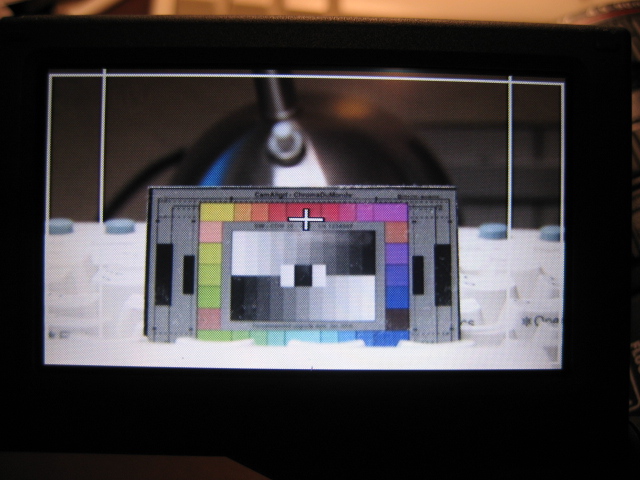

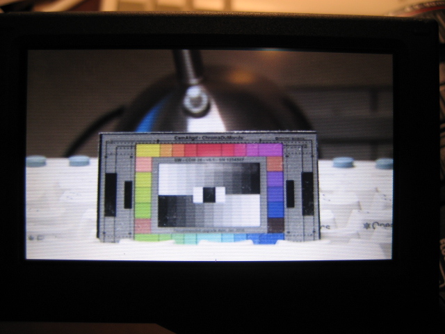

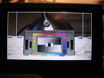

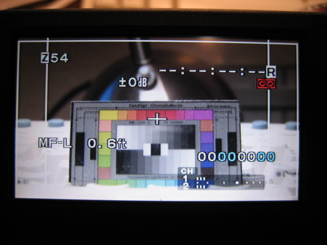

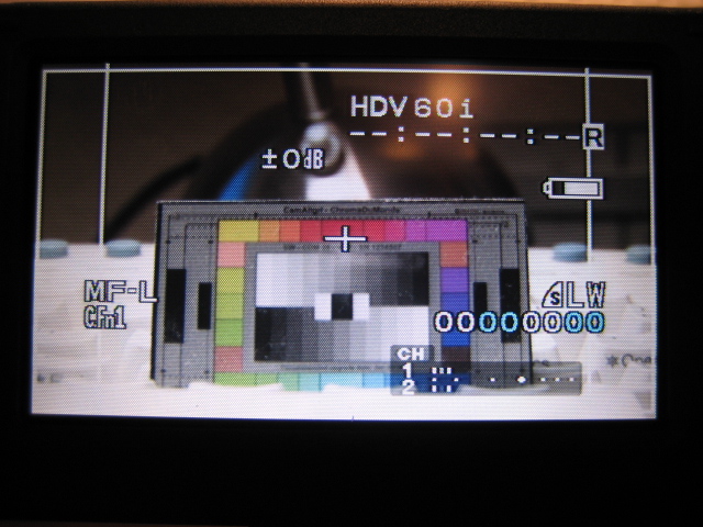

I can see that some of you guys are having a hard time activating your custom display settings. Here's a step-by-step guide describing exactly how to display zoom and focus info permanently.
1. Go to the Custom Functions menu. Under option 12 (zoom indicator), choose setting 01 (number). Then choose "apply this set," and "active." Close this menu.
2. Go to the Custom Display menu. Under option 03 (zoom), choose setting 02 (on always). Under option 04 (focus), choose setting 02 (on always). Close this menu.
3. Activate the custom display by pressing the Disp. button on the camcorder (found above the Peaking button). The first push brings up your settings (in this case, the zoom number and focus distance are "now always on" in the viewfinder). A second push of the Disp. button removes everything but the aspect ratio and centering guides. A third push clears everything out of the display entirely. A fourth push returns to default -- not your custom settings, but the camera default.
Press the Display button numerous times in succession so that you can get the hang of how it works. It cycles through four different settings:
Default > Custom > Guides > Off > Default > Custom > Guides > Off > Default > Custom > Guides > Off, etc.
See attached pics for examples.
If for some reason this isn't working for you, it's because you've missed a step somewhere. Go through this post carefully and it *will* work. It is not necessary to save anything to the memory card! You don't have to do that to get the custom display settings to work. All you have to do, is *activate* the settings using the Display button as explained above. Hope this helps,
