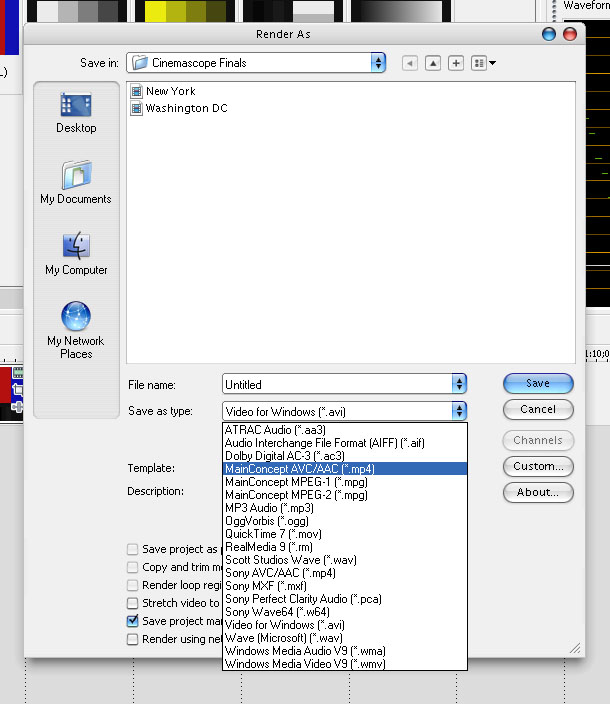

If you have Vegas 7, you can compress directly out of the timeline. It's under AVC H.264 as a format (not under the QT7 tab).

Here. Only in Vegas 7.

Obviously there I things I need to learn about Vegas. Thanks Bennis. It's interesting that it's not saved as a .mov but instead an .avi. That confuses me a bit...
So we have a codec that is better quality and compatable with mac and PC. Maybe a switch is in order for high quality web delivery.
-Jonathan
