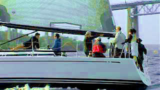

Three frame grabs from a shoot last night with the A1.
I can not seem to solve the aspect ratio problem with frame grabs from Avid Liquid. They are in the right aspect ratio and size in Liquid but when I switch them to any other software they are squeezed. This happens even though they are the correct size. Thoughts?
Also I can not seem to upload .bmp files so I switch to .jpg. Both are with in the size requirements but maybe this is related to the Liquid problem.
It was a wild evening with the colors and haze.
30F
60 shutter
Iris 3.4 - 6.7
Formatt 1.2 ND filter
All are very close to full zoom
Two are auto focus and one is manual
Vivid preset except the dark is my preset
Paul Cronin
www.paulcroninstudios.com

Here are the three pics and proper aspect ratio thanks to Steve. I do still have to change to .jpg over .bmp since .bmp fails to upload.

This camera's settings as it comes from the factory the black are so stretched.
Here is a manipulated image.
Douglas Villalba - director/cinematographer/editor
Miami, Florida, USA - www.DVtvPRODUCTIONS.com
Douglas Villalba is offline   Reply With Quote
Old May 16th, 2007, 12:59 PM   #101
Location: Rhode Island
Posts: 4,048
That shot was me testing my preset. Also this was just as a dark cloud came overhead. So you are saying I should change the black stretch to press not mid?
