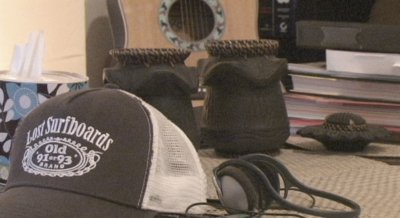

Hello there,
I just got my Canon A1 a couple months ago and had the chance to use in a shoot. I rented a second one for that shoot from the same store I bought mine.
At the shooting day, my DOP and I looked at both and thought the image to be a bit weird when indoors. I have placed here screenshots of the high res images of the footage both indoors and outdoors.
The settings are all original from manufactory. Only one image has Steven's preset which helps a bit but you will notice the grain is still there.
Should I bring my camera back to Canon? Is anyone experience this same problem or am I doing something really wrong?
Thanks for the help!
Paulo

Turn off the freaking auto gain.

Agreed. Turn of auto gain. It only took me about six months to realize my FX1 was pumping autogain, when I thought it was off. I think A1 works the same way, you have to select a gain level with one of the switches, and make sure that gain level is set at 0. Otherwise, the camera adds gain even though you think you are adjusting without it... grain shows.

It does not matter if you have your preset on 0db or what, the auto gain switch must be off, now if the light level is low, the first thing you want to adjust is your apperture, open that all the way, if it is still too dark then add 3 db gain, if it is still too dark then go to 6db and so on, gain should be the last thing you want to use because more gain=more grain, now if you don't mind about smooth video then you can also take your shutter speed down to 30th of a seconds or lower to gain more light. A1 is a manual camera, it is not a good auto camera.

Yep, gain is artificially increasing sensitivity of the sensors by applying higher currents/voltages. Gain is "digital". In a way, gain to the sensor is what digital zoom is to the range - it tries to create more out of less. Aperture is what optical zoom is to the range - it increases the amount of light that is hitting the sensor. Open up the aperture (use lower F-number), or slow down the shutter speed - that comes with the price of motion artifacts, but you can lower the shutter speed from the usual 1/60 (if you are shooting 60i) without introducing much artifacts by setting your shutter speed to 1/48 and shooting in 24f mode.
