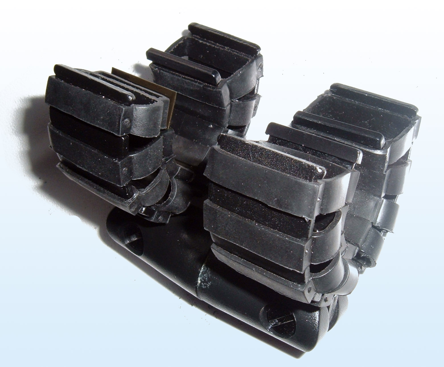

Good mic suspension for £17 (for UK readers!!)
I created one which cost me about £17. See attached photo.
You need a couple of bits from Maplin:
2 x Shockmounts http://www.maplin.co.uk/Module.aspx?...=9830&doy=17m5
and
1 x adaptor (one as in the middle photo)
http://www.maplin.co.uk/Module.aspx?...=3569&doy=17m5
You screw the adaptor halfway into one of the shockmounts, then screw the other onto the exposed half of the adaptor. The bit in between the two mounts then goes into the circular clamp and you clamp it shut. The two shockmounts ideally need to be a bit more separated so a few washers might do the trick but this does work very well on my long sennheiser / rycote softie kit, and it reduces any thumps and bumps to almost zero. I use these shockmounts on all my static mic stands too, for recording.
Hope that's useful
Mark
