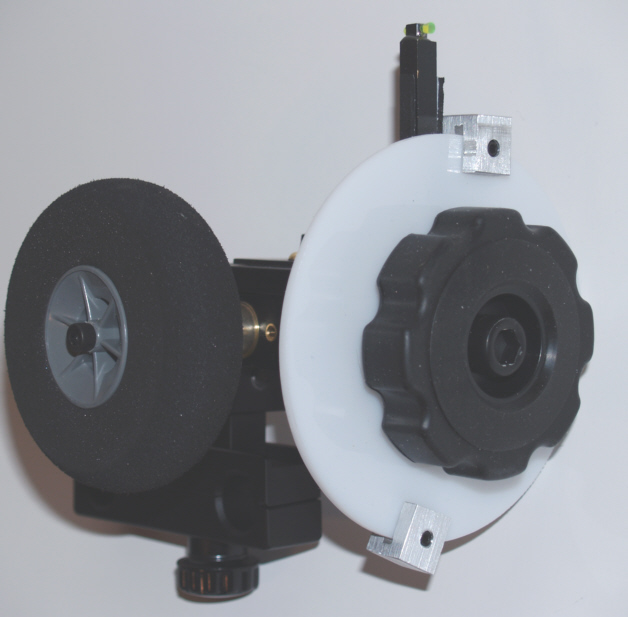

The other thing I'd like to have is a follow-focus wheel. Now I know the XH A1 is a 'fly by wire' camera and actually my interest is not doing technically perfect narrative follow-focus shots but I do like the idea of focusing this camera manually with a FF dial. The mattebox above needs rails, thereby blocking access from underneath and has the AIF sensor and XLR ports on the right-hand side. I also prefer to focus with my left hand, and like the possibility of using a whip to keep vibration down.
I just saw this and wondered whether anyone here has used it?
http://indifocus.com/indifocus.html
Looks a little bulky but actually that fat rubber wheel and the focus ring on the Canon might mesh pretty well.
Anyone have any experiences or observations they'd like to share?

I find the focusing ring to be fine. I don't know why you'd want a follow focus wheel unless you're doing dolly shots and have an assistant to follow focus. One thing you need to do is go into the custom menu and change the default focus ring speed setting to slow. For some reason it comes from the factory on the fast setting, and that's almost impossible to use.

I was also wondering if the IndieFocus system (photo attached) has been used successfully by anyone on the A1/G1? Looks like it should work...
