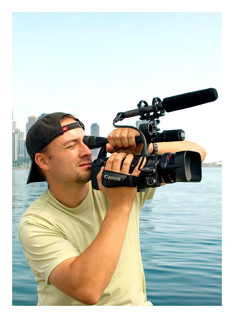

This was my setup:

I finally looked at the photo with the mic mounted on the camera. Obviously he would have been recording only ambient effects, so in that case it might be best to just use the in-camera mic. It's not all that bad if you just need traffic noise, etc.

Modify the rig
Just a note, as I'm using the same camera and mic combo:
1. invest in a 'dead-cat' furry windscreen (preferably one that fits over the stock foam windscreen). It will take out a measurable amount of wind noise.
2. If you are using a hot-shoe mic mount (which is fine), but need to use a hot-shoe accessory in the future, I would recommend taking the AT-897 shotgun and fitting it into the Canon's stock auxillary mic holder, with foam padding (or soft rubber padding) to make up for the small diameter difference.
3. Carry a set of portable earphones with passive noise cancellation (silicone rubber earcups that fit entirely in the ear). This works wonders in noisy environments (especially near bands and dj's when you want to concentrate on the recorded sound). I bought a Creative Labs pair for $35 and they rock!

I dissagree with suggestion #2. The mount he has will do a better job isolation/preventing camera nise to the mic that putting in to the stick mic holder which s not shock mounted at all.

The stock mic holder on the A1 contains some isolation padding, just not a lot. It is most effective if the mic is not clamped down tight, but fairly loose.

Hey Roman,
Nice setup! I have a very similar setup to you, only it's a rode shotgun mic. Could you help me out and show me the exact XLR cable you got for your shotgun mic in the picture you posted? My XLR cable is a bit longer than your's it seems and I'd love to tighten it all up. Any help is greatly appreciated. Thanks.
