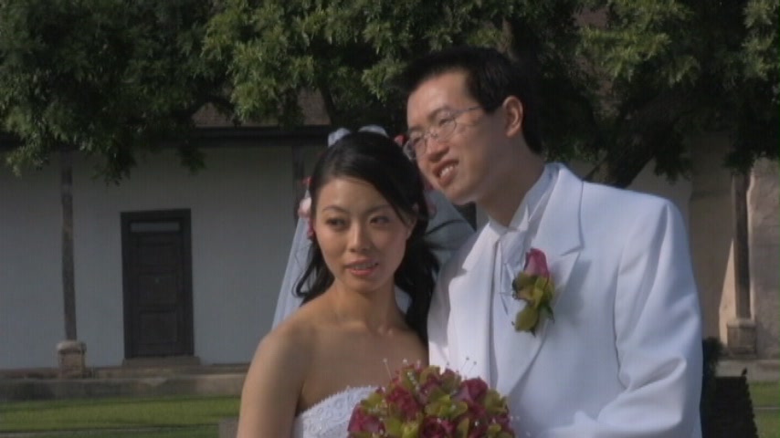

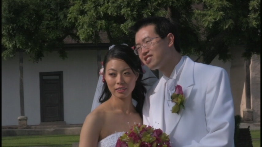

I shot this video in HDV format using HV20. Captured both in DV-Lock within the camera, and, HDV then downsize to DV in Premiere Pro. Check out the difference yourself.
