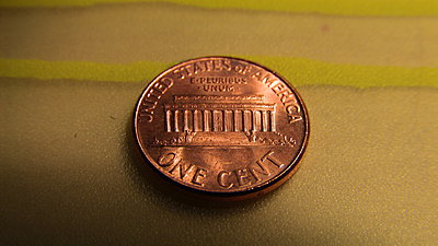

Century Optics achromats are top notch. I use 7235 which has 3.5 magnification and I love the results. I bet 7220 is great also, just with less magnification.
Attached is a quick handheld example taken in Photo Mode. In this case focus was set on the center of the coin, but if you're after corner to corner sharpness in flat images, it will be very good with those diopters.

Bogdan: Nice photo. What zoom setting did you use for the photo of the coin, or alternatively what was the distance from lens to the coin?

In this case I was close, about 1.5" away with zoom set 55 or so, but of course other distance/zoom settings are possible as long as lens can achieve focus.
