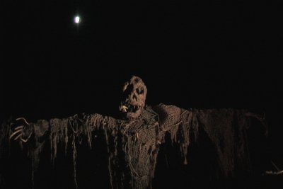

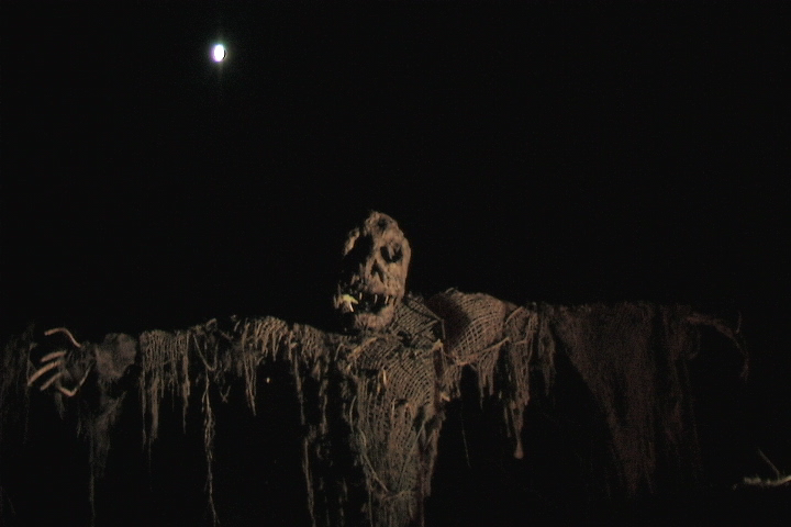

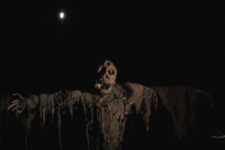

Every year I shoot video for a local haunted attraction in NH. Every year I'm confrunted with the same problem. Lighting! There is simply not much lighting. The lighting that I do have to work with is typically colored lights projected onto props. I have to shoot outside in the dark.
I have tried to use "on-camera" lighting in the past. However, it really takes away from the colored lighting. Also - when I crank up the gain... I get grain. I went out to the site tonight to try a few experimental pre-sets. The site was only lit by a few white lights here and there (it's still under construciton). The light was actually a little worse than normal.
I made three pre-sets.
LowLT1.bbp = Least grain (at +6 dB)
LowLT2.bbp = Slightly more grain - more overal detail in the shadows (at +6 dB)
LowLT3.bbp = A lot more grain - a lot more overal detail in the shadows (at +6 dB
I've attached three screen grabs for each setting. My goal is to have three presets that will give me options depending on the amount of light avaiable. Option-1 (best lighting conditions), Option-3 (worst lighting conditions), Option-2 (somewhere in between 1 & 3. Here are my current settings. Any help would be appreciated!

I must admit. I really can't tell the difference between these screen grabs. There is a big difference when viewed on an NTSC.

I viewed them as a little slide show in the order you posted them. At first, I thought there was no difference between #1 and #2, but after clicking back and forth several times, I could see and improvement in #2. There is a good jump between the first two and the third.
The amusing thing is, that when I clicked all three quickly in order, I could watch the moon rising.

Yeah... I did notice that the moon was moving. It's funny. There was only 3 to 4 minutes total between all three shots. Fast moving moon.
I have a hard time telling the difference between the stills. It's easier to tell the difference on my NTSC video monitor.
