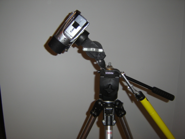

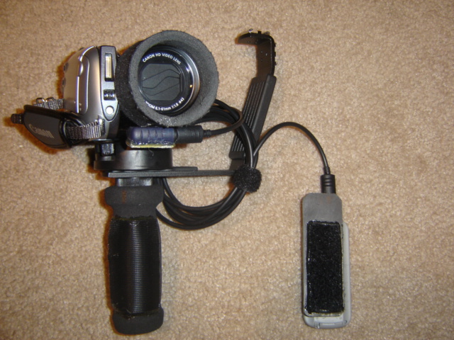

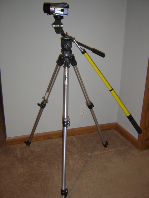

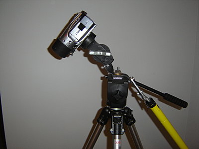

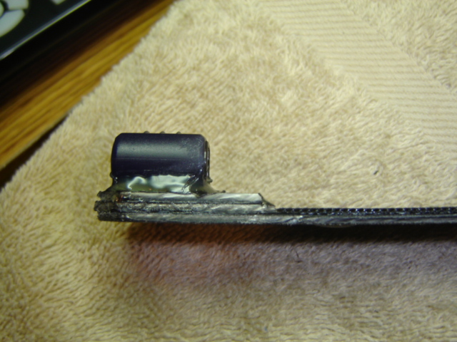

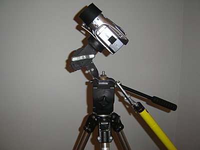

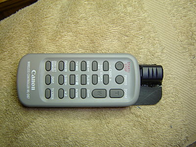

I've been using the TV as Monitor and the Pana's (& now the Phillips) HHD/Burner units for a number of years now. Mostly doing Horse Shows.
Putting to the HHD's allows for basic editing and making as many DVD's as you want. I will also back up to RAM or DVD-RW's for the important stuff.
I also use my custom made Extendable Control Handles and IR-Remote's by FiberOptic cable, in addition to an vertical articulating Cam to Head mount.
I have found these Mods to be extremely useful for any motion type Video.

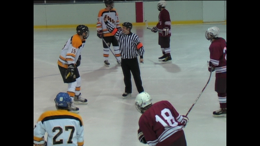

Yes here ya go...
These are captured with pinnacle studio using firewire. I left them in the original .AVI format so they are very large despite the small footage.
I have included 3 files. (I hope I have these correct)
1.) 20x lens, f1.6, shutter 1/180, 60i
2.) 20x lens, f2.2, shutter 1/120, 60i
3.) 3x lens, f2.2, shutter 1/120, 60i
FYI - I have yet to figure out how to host the video's on my website the correct way (I am the techie on that also). These are just links and you can download the files.
http://visualboxscore.com/boxscores/....6_180_60i.avi (142 MB)
http://visualboxscore.com/boxscores/....2_120_60i.avi (92 MB)
http://visualboxscore.com/boxscores/....2_120_60i.avi (91 MB)
also here is a still from the #1.
