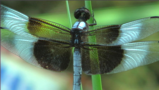

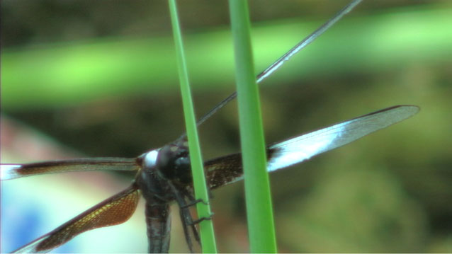

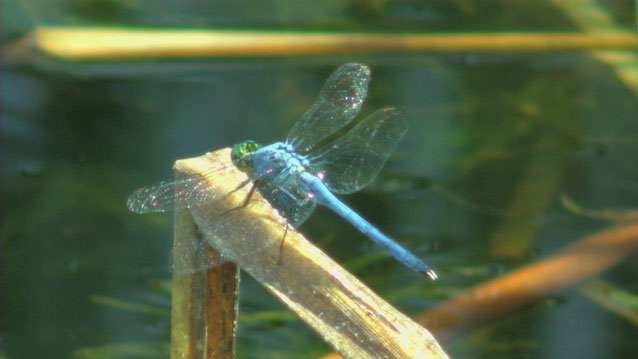

Picked up a used Nikon-to-XL2 adapter through the forum last week, and just got through downloading the first video using a 300mm Nikkor lens. Using the 7.2 multiplication factor, this translates roughly to a 2700mm lens in the 35mm world. I have an ongoing project documenting the wildlife and changes at a pond just down the street, been going out regularly for about a year now. A floating raft of water weeds forms about this time of year in the middle. I've waded out with the XL2 to cover the action on the weeds, but the critters all run when I get close enough for the 20x zoom. The 300mm should let me stay on the shore and spy on the party in the weeds.
These initial frames are of dragonflies, shot from about ten yards away. No cropping, full frame shown. With that much magnification, you can't really follow them. Dragonflies are territorial, though, and have a regular "station" they return to after chasing off any intruders. All you have to do is focus in on their station and wait for them to come back. Hardest part is keeping the camera still. Even on a heavy tripod, wind shake is a problem.
Gotta love that prime Nikon glass.

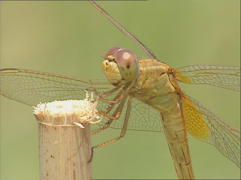

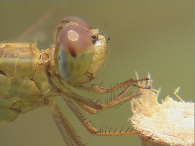

I agree with all Tony has said but if you are prepared to wait at a spot you see the dragonflies frequenting it is possible to get shots like as attached. You will need a very heavy tripod. These were shot using a Canon 300mm T2.8 FD lens with a diopter attached to the front of the lens, so I could focus close enough.
