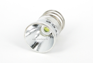

Yea, I agree -- it's always scary to trick around with the camera power. So I decided to get two 300-lumens LED's that will handle up to 12v, and then I'm gonna gut-out my old Bescor lights, mount the two 6v battery packs in serial (to get 12v) to run the LED's. Hopefully that will save me some dough on a nice LED light set.
-- peer
Here's the LED's I'm getting:
www.NoPEER.com

I got those bulbs from eBay Store - LED: surefire, G P, solarforce And I'm just cleaning up the shop after drilling, cutting, soldering, and swearing -- but I'm happy as a clam -- the lights turned out perfectly. My only concern now is that they might be too bright, (at least for interview footage, etc.) and the color temperature -- tomorrow I'll try to figure out what filter I'm gonna use.

As far as the color temperature goes you can always balance your whites with a white card.

Of course, but then again, the background will look yellowish.
