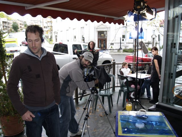

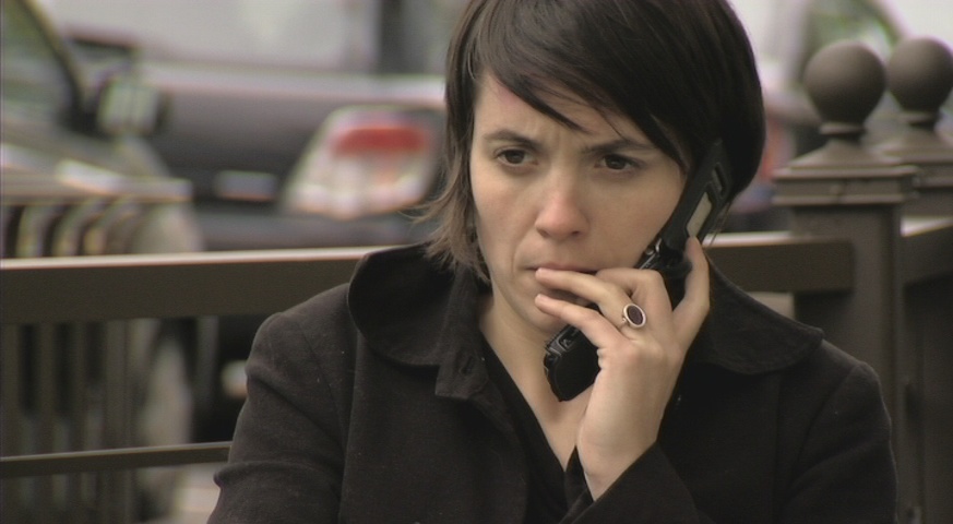

Here are a couple of examples of creating an apparent shallow DoF.
The first pic is the set up. The subject is mostly hidden behind the girl in black standing on the right, but it's enough to see the relationship between camera and subject, and subject and background.
The second is the final shot. Everything behind the subject is nicely blurred, bringing the focus of the eye where it belongs.

Thank you everyone for your advice, and to Jack for supplying the images.
