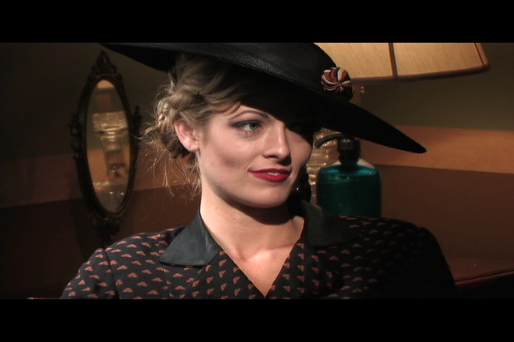

Oh yeah. One other thing. The Jpgs posted earlier by someone showing the ceiling of the Expo center.....those were really...really soft images...out of focus slightly. THis scares me a little also as I love the hi res sharp images of the DVX. Please tell me this was just a bad focus and not a sign of soft focus issues on the unit. please.....
Marty Hudzik is offline   Reply With Quote
Old July 20th, 2004, 06:37 PM   #8
Posts: 27,382
Try this image instead: www.dvinfo.net//canonxl2/images/danascott.jpg
Reports from the first buyers should either confirm or deny your fears.
