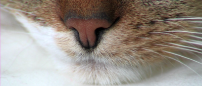

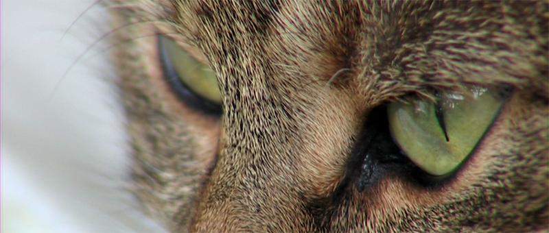

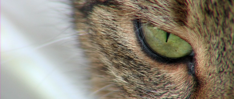

I have started using more detail after som lookaround in the forum.
Now using:
Gain: -3
Gamma: Cine
Knee: LOW
Black: STRECH
Color matrix: Cine
Color Gain: +1
Color Phase: +1
R: +1
G: 0
B: 0
V detail: LOW
Sharpness: +3
Coring: 0
Setup Level: -4 / -6
Master Ped: -3
Nr: off
It's nice to see how well the cam uses high detail settings. If I compare to my previous DVX100A the grain would stand out with the Pana cam.
Off cource viewing this on a broadcast monitor makes it look even better. This was shot handheld from the waist. Lens was 16X manual.
A tip on custom settings....-untitled-2.png   A tip on custom settings....-untitled-1.png

Hello,
Great detail with the cat!
I find that when I'm shooting general topics for my corporate work that I have ti soften the sharpness to eliminate shimmer. SD DV has many challenges like stair stepping, bending off lines, etc. although shimmering is not limited to DV, it seems to be more pronounced in DV.
Your cat is organic and the sharpness is great for detail, but non-organic objects such as metal or especially metal grills on cars where you compound the metalic shimer with line complications can drive you crazy.
What are your thoughts on that?

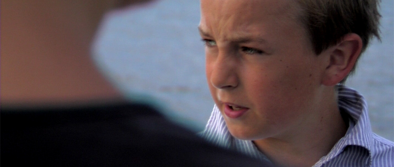

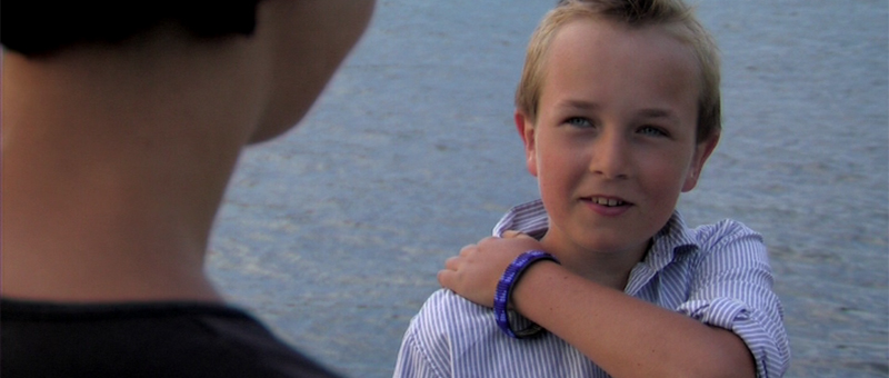

Hey Anthony,
I will try that out, going out sometime soon again. I’m still learning so it will be interesting.
What I have noticed is that organic object, like faces, also often looks better when viewed on a broadcast monitor with lower detail settings, although this is assumptions. These below are with -2 in detail, and it also helps making the focus soften between prime focus and a bit of. With the viewfinder I find if often hard when fining proper focus with moving objects.
I'll post again with something non organic.
