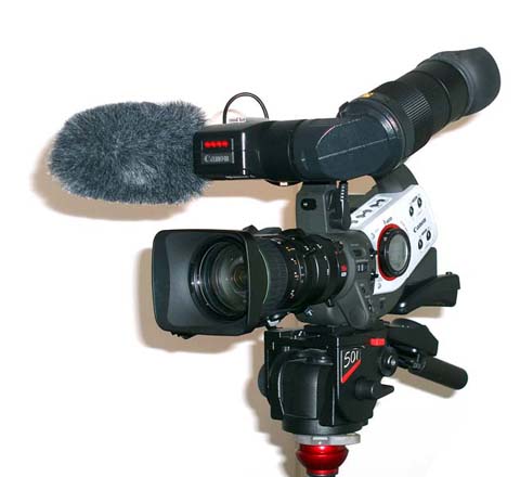

Originally Posted by Mark Sasahara
You can also do as Camera Assistants do and use a tape measure to check the subject distance and then set the lens accordingly. Be sure to check that the engraved distance matches the actual distance first. At the beginning of the day, after the camera is assembled, check the closest distance and then check a few other farther distances. So try 4.5 feet 6', 12', 20'.
Ah, but where do you measure from? I work in a camera shop and a large number of the digital and film SLRs have a mark at the film plane, (looks like a plimsoll line) I can't find it on the XL2.
I'll also bear in mind the 3x & FU warnings. I've sent my 3x back as when you set it to manual focus and zoom, it sometimes pulls the focus with it, ireespective of the focus's orginal starting point. Also there is no way on the planet you can manually focus smoothly with the 3x, the servo always jumps and stutters. Canon said 'No fault Found', surprise surprise!
Here is my current setup (if the upload thing works.....)
Oliver.
Oliver Horn is offline   Reply With Quote
