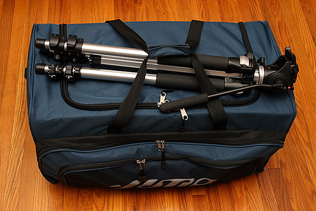

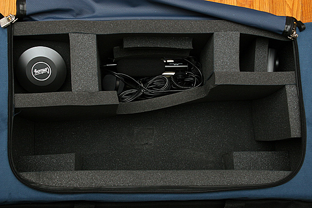

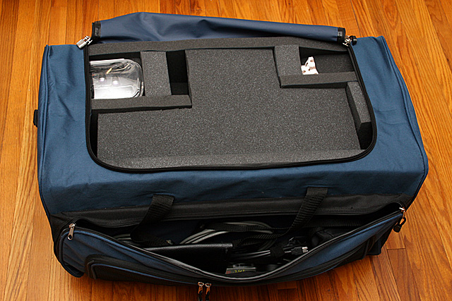

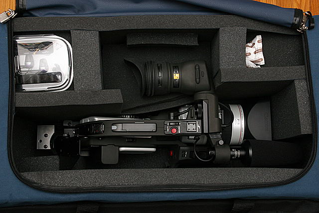

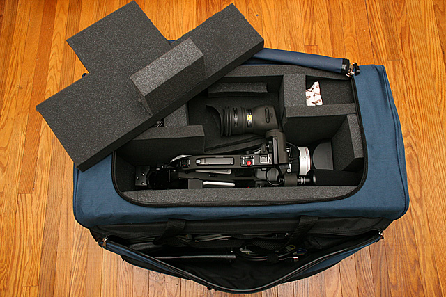

This is a bag I made for my brand new XL2 after looking around for good bags. I didn't like the offerings around, or if I did like them, I didn't like the prices. I made my own. $14 for the duffle bag, $40 for the foam, and $9 for the adhesive spray to glue the foam together. It is durable and protects the camera very well so far. It holds the XL2 fully assembled, the charger, batteries, Century 0.6x, wireless mics and wired mics, remote, earphones, cables, tapes, and all kinds of extra bits with room to spare.
http://www.atsi.ca/images/xl2/xl2bag1.jpg
http://www.atsi.ca/images/xl2/xl2bag2.jpg
http://www.atsi.ca/images/xl2/xl2bag3.jpg
http://www.atsi.ca/images/xl2/xl2bag4.jpg
http://www.atsi.ca/images/xl2/xl2bag5.jpg
If you want details on making this, I would be glad to provide them.

Old June 1st, 2006, 02:27 AM   #2
Posts: 8
Good job!
As for me, I went with a knock off hard case from ebay (it's half the price of the official Canon hardcase for the XL-2) for the added comfort of knowing that it can take a few hard hits here and there.

The foam I purchased was from a local plastics and foam business. I believe it is called urethane foam and you should ask specifically for equipment padding or case foam. There is a much rougher type of foam used for packaging that you do not want to use.
The bag I used alread has a rigid bottom and has wheels on one end. The dimensions are approximately 14x14x27 interior. The one thing I will be doing is adding a rigid side panel on the camera side. I am sure that this bag will not meet carry on size, but I could be wrong.

a bit of advice on improving your design, you might want to figure out a way of sewing or gluing the top part of the foam to the top flap that opens up. I went up to some huge camera shop in Palo Alto / Stanford area. Keeble & Shuchat Photography. The place is big. They've got two stores one on either side of the road. One for buying stuff and one for renting stuff. I think it's a very cool looking place, but i walked in and immediately got some salesman. He didn't know what an xl2 was, he assured me that it used a 77mm uv filter, ZOMG i wanted to punch this guy when i got back to my class and the stupid filter didn't work, i live in monterey so thats like an hour/hour and a half drive home with the wrong lens. Luckily my mom likes to go shopping at Nordstroms up there so she took it back, but i did get sold on some 300 dollar XL2 bag, the only bag in the store designed for the xl2, i can't believe some of you have hard cases, this cloth/foam combo bag is way heavy with all my gear inside & tripod in other hand heh, but i really needed a bag, i couldn't let this sucker sit around, its a 3000 dollar camera, well thats what i paid for mine brand new heh.

OK, I will post more details. I am not interested in making them for others but don't worry it is so easy to do. I am looking at a couple of iprovements like adding some stiff sides to prevent crushing. Other than that I am very happy with this as is.
