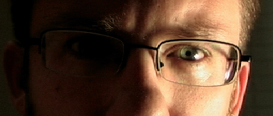

Here's an interesting grab from some test footage I did with a new home made gold reflector (ie, the fabric store had a sale on shiny gold stuff).
However, there are still some jagged edges (see top left and right corners on the glasses frame) and some strange verticle banding on the nose...
Is this just something I'll have to live with when viewing footage on a computer?

Where are you seeing this? In what program, on what monitor, etc.?

Filmed on an XL2 with the preset you gave me minus the color tweaks. 16:9, 24p
I captured into Premier Pro 2, this screen grab was from AfterEffects. I'm using a Samsung CRT monitor (SyncMaster997mb), high rez...Seems the image on a TV is a bit smoother though...just so strange for it to look so rough on a computer.
...and GEEZE I wish I had the 3x Wide Angle lense...stupid small house cant get the camera far enough away grumble grumble grumble...
