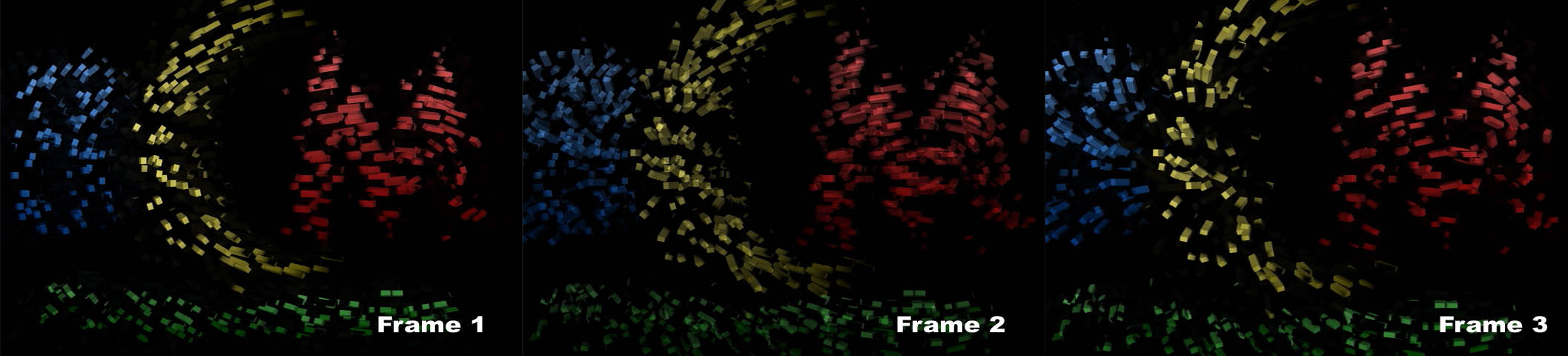

FCP uses frame interpolation just like Ppro. When comparing these two methods the only pros I can come up with is that there is no lose in detail in the frames that were actually recorded. The cons outweigh the cons of line interpolation however. Slowing down a clip 50% means two frames have to be blended in order to create a new frame. I have attached an example of an exploding brick wall I made then slowed down with frame blending. Frame 1 is a real frame. Frame 2 is made by blending frame 1 and 3 together, you will notice that there are 2 times as many bricks in it then the others and they are opaque. And Frame 3 is a real frame. Basically Frame 1 and 3 exist in frame 2 but are at 50% opacity.This is the drawback for using frame blending. If I were to have done this the 60i to 60p to 24p way it would have only slightly lost vertical detail, and with the XL2 when you shoot progressively its recommended you turn vertical detail to low anyways, so it would match up great.
One other thing. This works best in After Effects 7 becuase the line interpolation software is better. If you are using an older version on After Effects it wont work as well. One way to improve footage is to just put a larger vertical directional blur on it. This will reduce the flicker effect.
