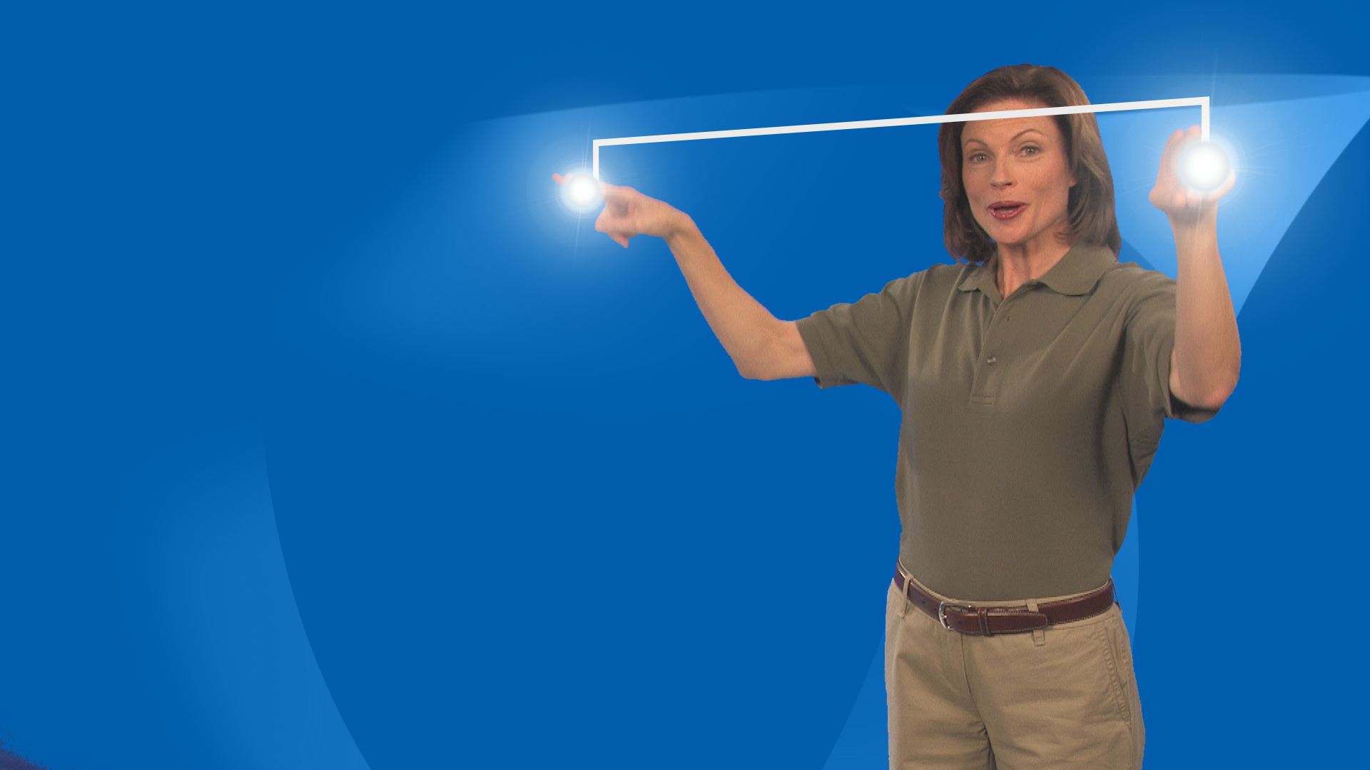

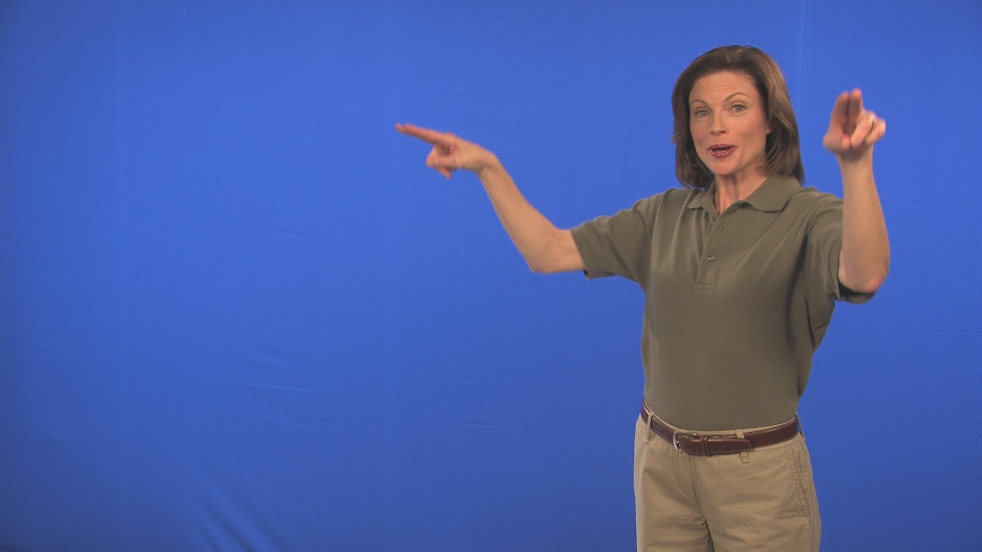

I put two jpgs here for you to see...
Please note...the jpg with the key is a quick comp from AE...(our artist is doing SFX on the footage...and there is a slight keying issue in the lower left corner)...but the AVID keyed these beautifully with little or NO tweaking.
I was impressed with the edges, hair...etc.
Another PLUS for the HDSDI output of this camera !

We just did a quick test with the "backup" HDV recordings we did on this job.
Digitized into AVID...and tried the chromakey. First try was perfect....chromakeyed perfectly !!!!
We could see the compression artifacts from the HDV on the monitor...but seriously...WOW...amazing. I can't believe the 25mbs HDV tape chromakeyed that easily.
Proves two things....1. If you needed to do a chromakey with just HDV recording, it will work nicely.
2. If you need to keep the HDV as a backup/emergency restore...there is no question the recording will "cover your butt" !

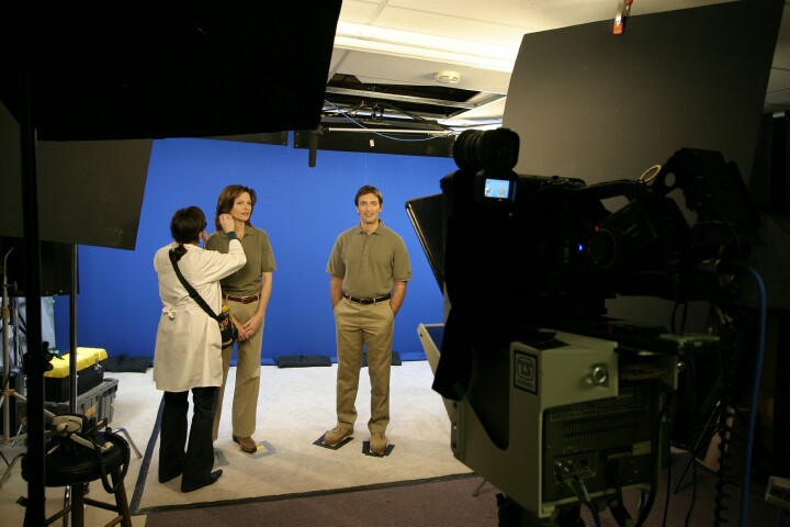

You said you have a small studio, how far away from the blue screen did you manage to place the talent?
I can´t see any blue spill light at all. Very nicely done

To answer a few of those questions and comments...
Our studio is only 24' by 20' wide. So it's small.
We have a 20x20 bluescreen that was streched on pipes and then spring clipped to stands...with sandbags at the bottom.
We hung kinos from our ceiling...there is a drop ceiling...which we popped out the tiles and hard mounted the kinos for maximum amount of height.
The kinos were 4' four bank lights. We used 3 of these to light the blue screen. Also....KEY POINT....our Gaffer...Mike Confer did a great trick. He lit the blue screen with 5600 kinos...while the talent was lit 3200k....Talk about making blue ....BLUE. It was awesome !
Also...talent was literally only 3-4 feet away from the backdrop.
Everything was shot at 60i.
When I get back into the office this week...I'll post a "behind the scenes" shot of the studio...and you can see how tight it is.
Kevin Martorana is offline   Reply With Quote

here's the studio shot...
You can see...not alot of "head room"...and talent was not far from the backdrop....
