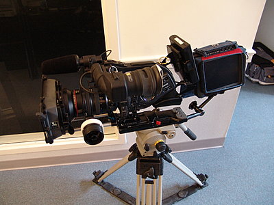

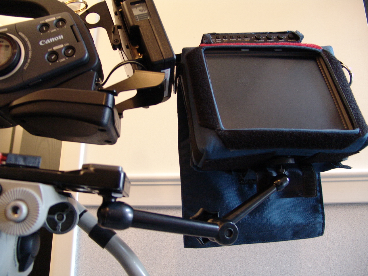

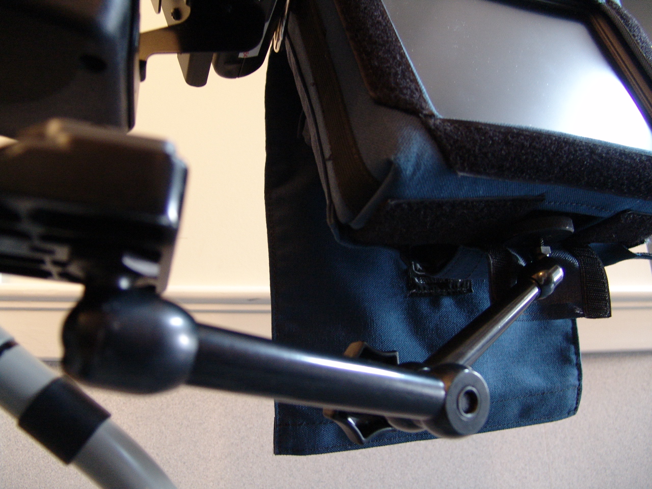

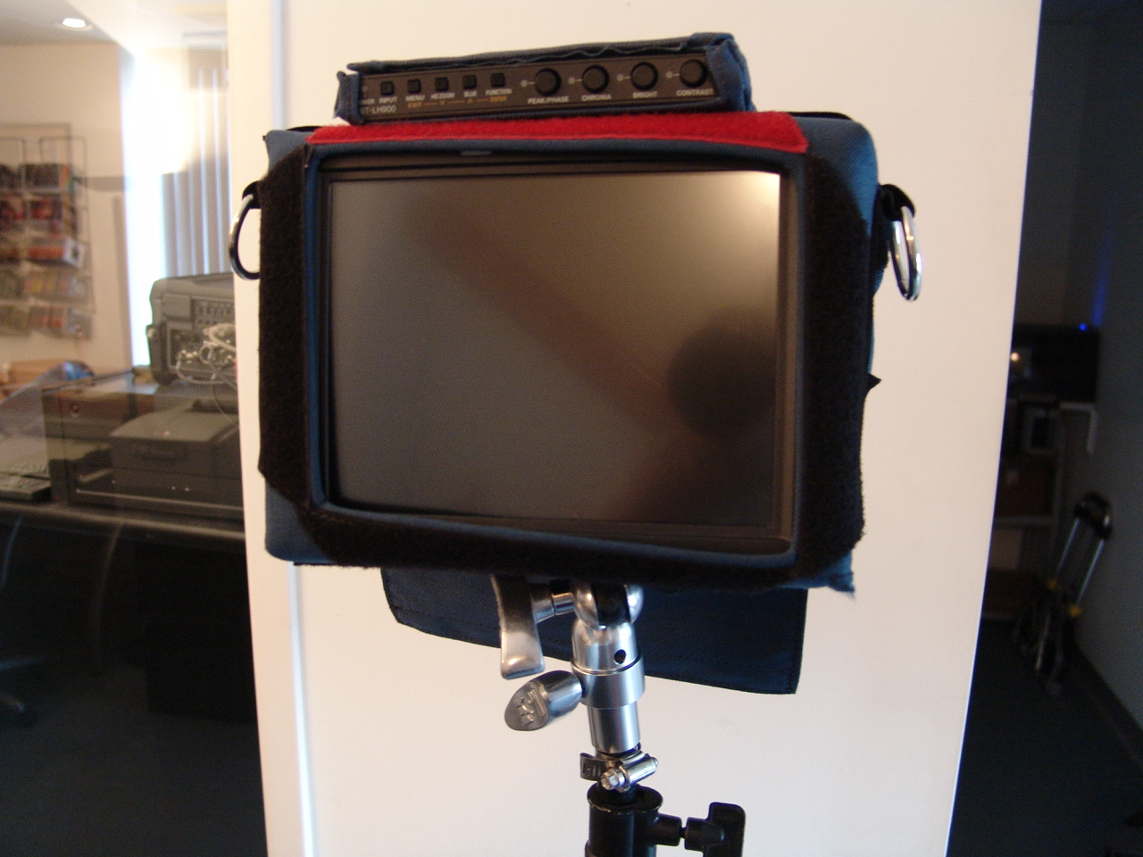

We use a Noga arm. Heavy weight one. If you're using a standard "sony style" camera plate...you'll have room at the end to attach the arm...then the monitor. If you're using the Canon plate...not so easy. It's too small to attach the arm.
Balancing is a bit tricky...but it works. This is good for studio shoots or tight areas.

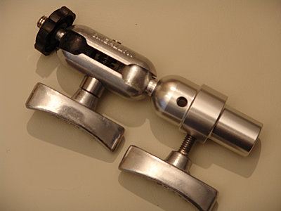

We had the fine folks at Matthews make us this monitor adapter. It attaches to any C stand or light stand. You can tilt the monitor in just about any direction with ease. This was a "custom" job we made up at NAB last year. This was about 100.00 US. Honestly...we use this about 90% of the time. With the weight of an Anton Bauer (and we have the TrimPak 14's)...that monitor gets heavy. FYI ...I believe the Pana's come with Gold mounts from AB...standard.
Another suggestion...get a small portable powersupply if you go with the Panasonics. They have the 4 pin connectors for power. Not just a +/- tip plug. Usually you would use a camera power supply....but there are a few (I think) companies making small powersupplies.....think laptop power supply.
http://www.minipunch.com/ Makes one...and we've been happy with it....Lightweight and just plugs in. Saves alot of weight and battery power.
Hope this helps ! :)

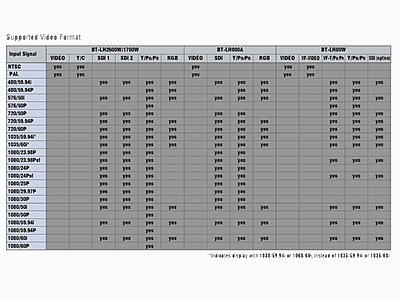

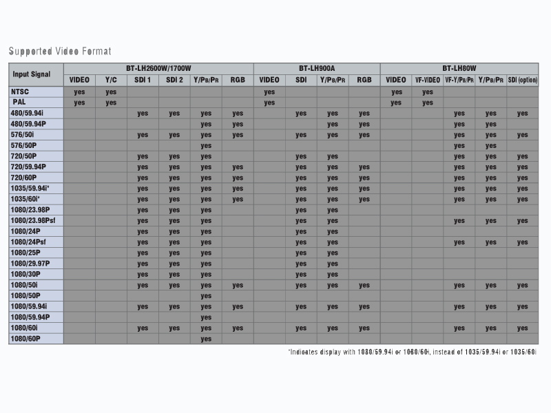

Kevin, does your Panasonic support 1080/25F? I am looking at the specifications of the BT-LH80W and it supports 1080/50i , 23,98Psf and 24Psf... is the 25F on the XL-H1 the same as 50i?
Floris van Eck is offline   Reply With Quote
Old May 4th, 2008, 09:02 PM   #24
Location: Lancaster, PA
Posts: 250
I believe only the LH 900 does...only with the sdi or hdsdi input...
I've attached the specs for the monitors with a jpg....
