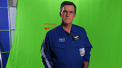

Record tethered to some type of uncompressed or ProRes format.
It will produce much better keys. We have done so numerous
times with great success.
Canon HDV is by no means terrible to key, but your edges
will look MUCH better by avoiding it.
Attached is an example.

Nice example. Any chance you can post the same shot acquired via ProRez or some other superior format? If not any other images we can do an A/B comparison on?
Also.....the HDV compression really blurs the small text on his shirt huh? :)

Sorry. This was from a quick and dirty HDV project.
I went through some old stuff and it looks like
we've converted all our raw capture to DVCPROHD,
so I don't have any samples on hand.
There are other examples out there on the web though.
uh... ya, another drawback of HDV. :)
