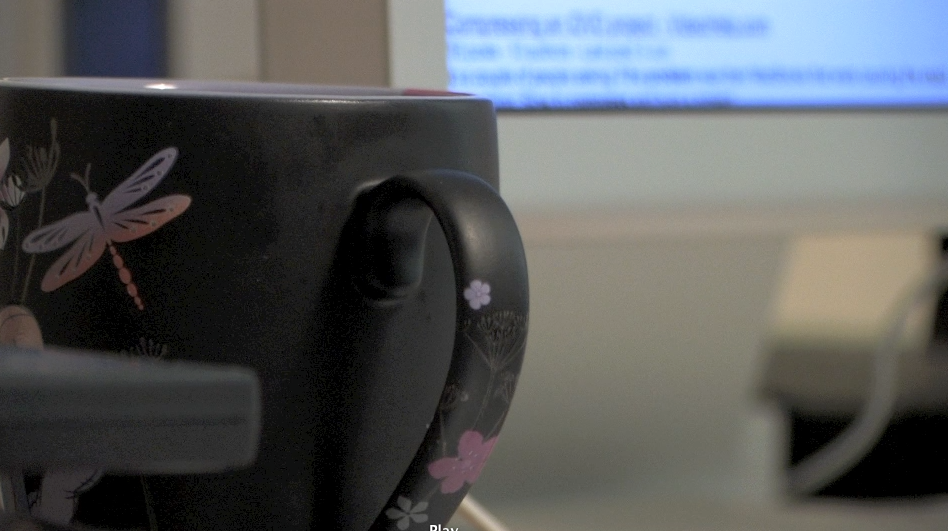

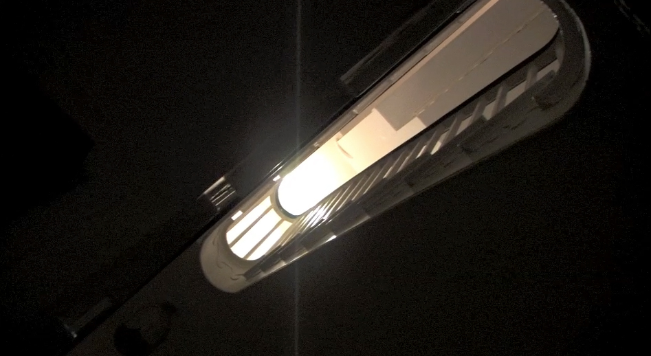

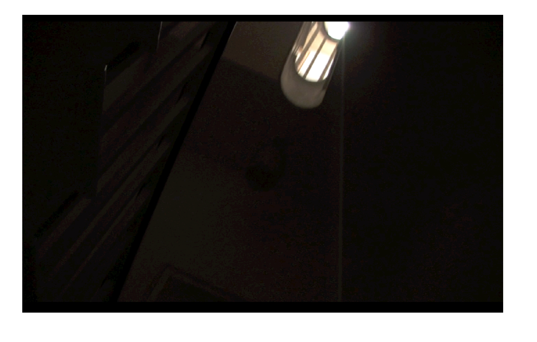

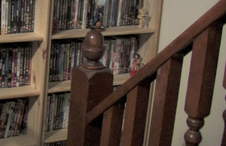

Just received my XL H1A and have recorded some random things, both in manual and auto mode. However I seem to be getting horrible results. I've attached some pictures.
Setup is HD
25F
Gain Odb or +3db at most on some shots.
shutter 1/50
I've tested in both low and bright situations, not sure what I should do. Am I meant to see some noise even in a brightly lit living room? I seem to be seeing both compression as well as noise together but I'm not sure.
Hope you can help.
Phil

I get noise too, and I haven't been able to find a setting where I don't have it. I do find its less when in brightly lit conditions, but I can notice it even when conditions are perfect.

Page 73 - XLH1 manual :
-3 dB Gain - For the lowest noise recording for indoor, low light or low contrast scenes.
My Chainsaw is permanently set to -3dB.

Thanks for the replies. I've since turned the gain down to -3db, which has helped, I also reset the camcorder, which also helped. Is there anything else you guys can recommend for reducing noise?
I'd be interested to see what others are using as their settings. I haven't tried using the Noise Reduction feature, would this be worth using at all with -3db of gain?
Thanks guys, really appreciate you help.

Couple Items in the Custom Presets Menu:
1. You can experiment with "Coring" The manual will tell you what that is for
2. Noise Reduction (1 or 2 - I forget at the moment which one introduces ghosting/trailing image with any movement)
Best advice to a new H1 user is to learn about the Custom Presets ... and learn how to download the wonderful Custom Presets that some very sharp people on this forum took the time to work up and Chris Hurd's efforts to catalog them for us. I especially recommend Steve Dempsey's "Panalook" custom presets.

However, the expectation that this is somehow a "noise free" camera is not reasonable. All 1/3" chip cameras have a relatively high noise-floor. If you flirt with underexposure (like the frames posted) you're going to get noise in the image. Most people concur that Canon's noise characteristics are the most pleasing of the lot. But it can be a noisy bitch sometimes.
Personally I'd rather over-exposure the image slightly and risk burnt out highlights than under-exposure the image and lift all that noise up.
