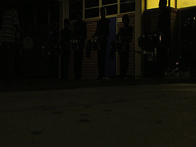

I've had my XL-H1 for two years. Had no problems up until yesterday when I started capturing I had shot a couple of days ago and saw three possible dead pixels. Right away I plugged in my H1 to my HD monitor and saw the three specs. I took the lens and cleaned just to make sure there weren't dust particles. Then when I put the lens back on they were mysteriously gone. So then I turned the H1 off and turned it on again and saw the three pixels.
I was wondering if anyone could help me out with this problem. Are they dead pixels??? Why do they come off and on??? Any Suggestions??? I've attached a screen grab of what I saw. Thanks in advanced!

Looks like you right. They can be removed but it means sending the camera to a service center. If you do search I think you will find of the forum I think you will find some answers as to what to do

Try blowing out the image for a few seconds and then restarting the camera.
This has worked for us in the past, but, ultimately, you may have to send it in to Canon to have the pixels mapped out.
