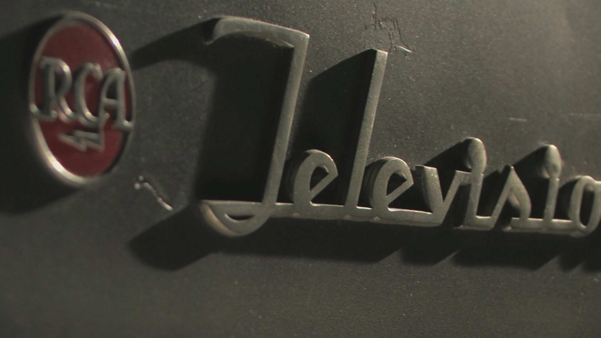

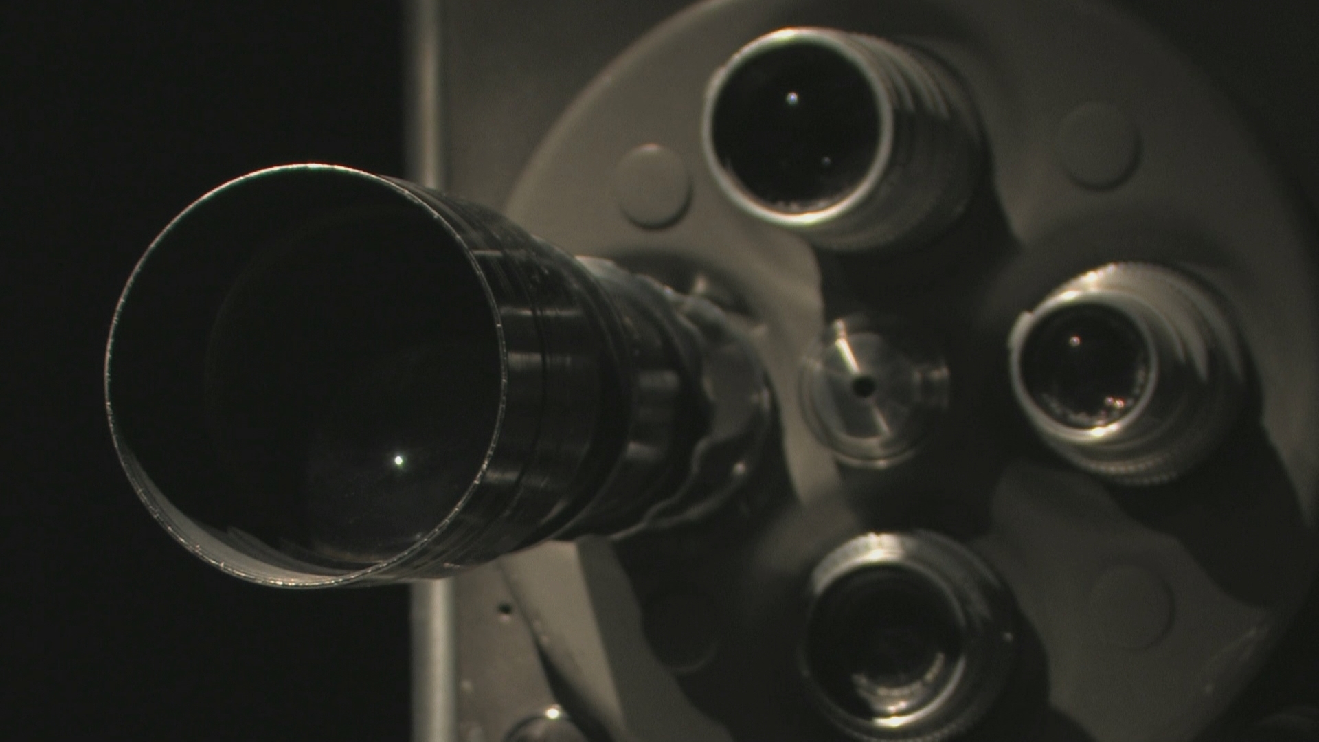

Hi everyone. I recently finished a 1 hr. documentary on the 60th anniversary of our local TV station, WGAL-8. In 1949 they went on the air. I produced the entire video, using old archival film that was "lost" in the attic, old photo and negatives and interviews shot with the XLH1. The photos and negative were scanned at 600 dpi then taken into after effects to be manipulated. The old film was 16mm mag and optical film. Some negative !! We projected the film on a white card...set up our Panasonic SDX-900 SD camcorder, shooting DVCPro50...and dialed in the clearscan...to get rid of the lost frames. It looks FABULOUS. (hey bottom line...I had a 10k budget for this whole thing...coming out of MY pocket !) So film transfer WASN'T an option.

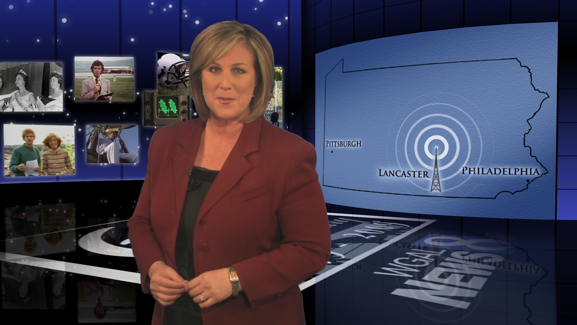

Originally, we had Willard Scott to host the program (WGAL is an NBC Affiliate), but on the day he was to do the "wraps"...he bombed on us ! That's a whole other story ! Anyhow..that was to be shot on HDCam SR by NBC...we would then transfer Willards stuff to our Avid Adrenaline...and insert into the show. Willard was going to be shot chromakey for insertion into our VR set. Well...I now had 4 days before the show aired...and had to do some re-writes on the script so the local anchors could do the wraps.
Well if you have to chromakey 25mbs HDV footage....it can be done. It's not PERFECT...by any means...but the keyer in the Avid did a fabulous job. Since time was of the essence...I didn't even bring the talent into OUR studio...I shot them on the weather set. I added 2 diva light for more PUNCH on them....and prayed !
Bottom line...I've seen alot worse on NETWORK shows !

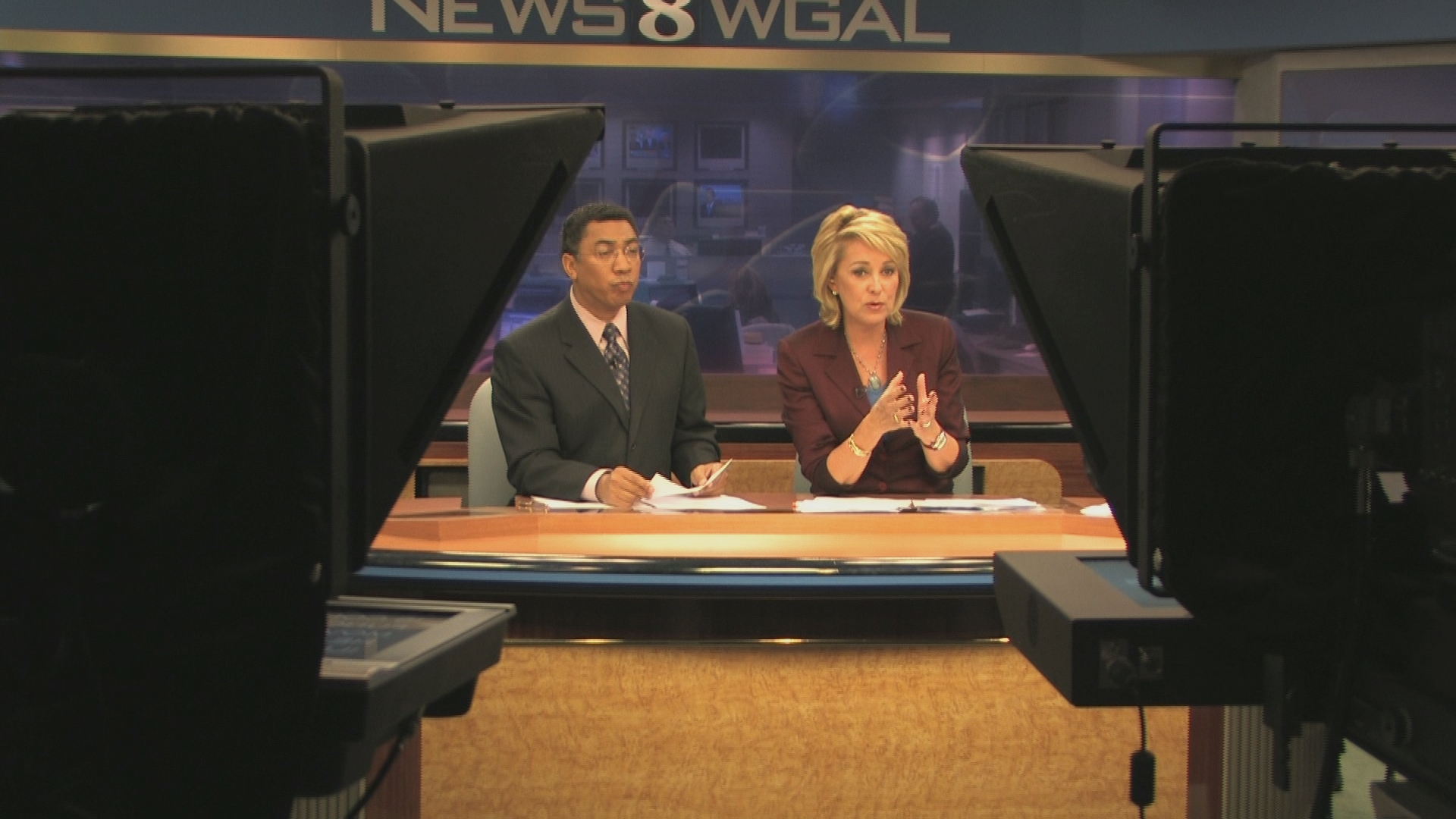

All the interviews were shot in studio on HDV in the Canon. I used a 35mm Kodak film preset and the 24f setting. As always...the images are stunning ! That camera can still cook !!!!
I've attached some photos

I enjoyed reading your post, seeing the stills and watching the clip. I like the score, the lighting on the vintage equipment and the camera motion you chose. Thanks for putting all that together.
