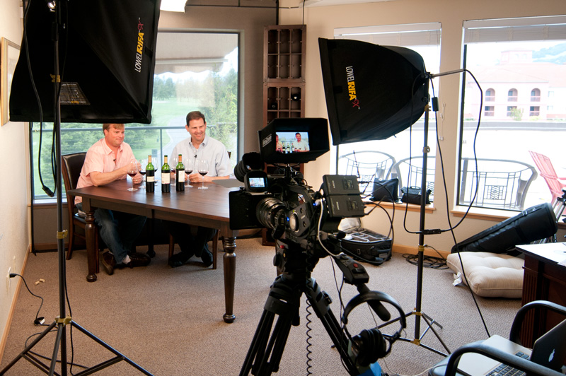

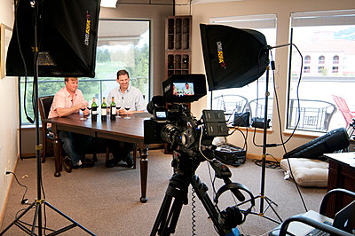

So here's my plan. As you can see in the attached image I'm using a 96" x 96" Wescott scrim behind then to stop the outdoor light down so it's not completely blown out (like in the 2 side windows on the right). I want to get the Wescott white -1 stop- scrim, mount that on that frame, grab 4 light stands and grip handles and set it up sort of like a tent over them. Like a giant diffuser (with lots'o'sandbags!). My assumption is that it will erase any hard shadows, stop the light down and clean everything up enough so that I won't even need any hot lights?

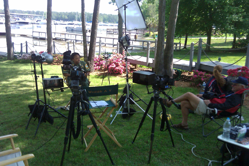

When I shoot outside, I use at least 3 HMI lights and a diffuser or sometimes even a white show booth tent to cut the sun.
The biggest problem is if the sun is going in and out of the clouds.
So my way of shooting is use a scrim/tent to diffuse the sun light the talent with a lot of daylight (HMI focusing lights are the best). The result is even as the sunlight changes the talent light stays very similar.
I do a lot of outdoor interviews that run all day outside. Below is an example of the lighting setup I used a few weeks ago in SC. I like to set up with the talent in dappled shade light and then diffuse that even more.
Outdoor lighting &/or diffusion-scshoot.jpg

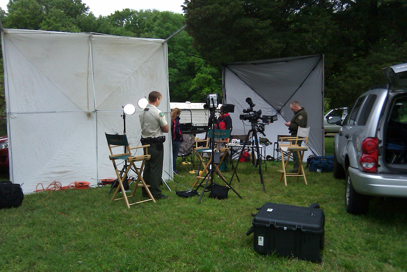

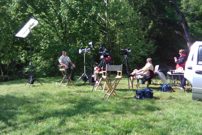

I have several different scrims and "tents".
Sandbags and anchors to cars and rebar pounded in the ground is what it sometimes takes to be wind safe.
Most of the time with a single person I use the 4'x4' with sandbags as seen in the photos below, that expands to 4'x8' if need be.
Here are 2 more cel phone photos. The one with the "tents" shows them on their side as wind blockers. It was gusting up to 30 mph and we had to create a lee for the audio. Miserable day thunder storms etc. Everything was anchored to trees cars and rebar pounded into the lawn.
Outdoor lighting &/or diffusion-tnshoot1.jpg   Outdoor lighting &/or diffusion-tnshoot2.jpg
