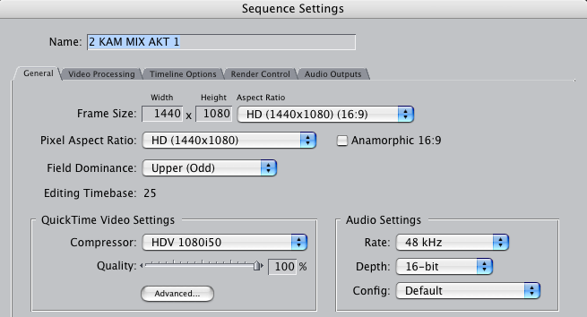

European models (25F) no problem. Record HDV. Don´t worry about the MPEG2, it looks stunning. Use good tapes to prevent dropouts. Capture using HDV or Apple Intermediate capture presets. Edit in a sequence using HDV 1080i50 compressor (25F and 50i are both interlaced streams) and 1440x1080 frame size. I have a G5 dual 2mhz and it works fine with two streams in multicam, but don´t expect more than color correction in real-time. With 4 streams it´s still playing but preview starts to degrade.

I'm still a bit confused by the setting of FCP for XL H1 25F material. Should the 1080i50 or the newer 1080p25 setting be preferred when editing in Final Cut Pro? Both seems to work.

Johan, I believe both ways work because the 25F stream itself is interlaced. Each of the two fields of 25F are showing half a progressiv frame. When played back the two fields appear as one progressive frame much like the prosess of actual film telecined to interlaced video for broadcast.
I don't claim to be an expert here but this is how I believe it to be.
In FCP I would choose 1080P25 to make shure no material including effects renders as interlaced.
