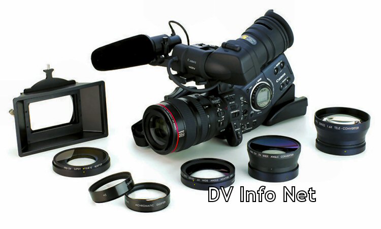

Old May 5th, 2006, 01:16 PM   #2
Posts: 27,382
Product line looks like this... more to follow... thanks Daniel!
