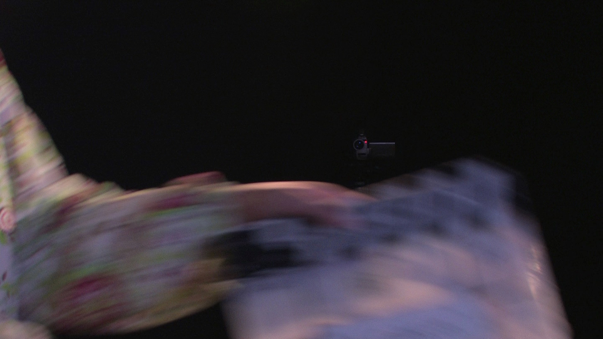

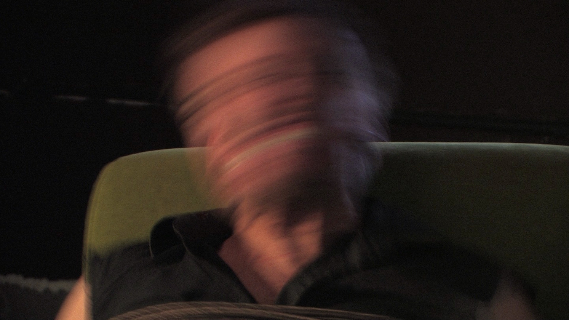

Hey guys, I've noticed on occasion I get a blurry motion if I have a locked down shot and a fast moving object. Almost a ghost-like image (1 image becomes 2). I output all my 24 F footage through firewire, so this cannot be a 3:2 pulldown issue. Is this just typical HD motion blur? Any thoughts? I've included 2 samples.
Motion Blur or 3:2 pulldown-blurexample.jpg   Motion Blur or 3:2 pulldown-blur2.jpg
Last edited by Brad Schreiber; September 25th, 2006 at 12:53 AM. Reason: Add sample pic

Hi Brad. Looks like motion blur to me, especially the second pic with the moving head. You can see the streaks formed by the eyes sweeping which you wouldn't get with interlace or pull down artifacts.
Video is more forgiving of motion blur than stills, but if this comes out too blurry on the actual video, I think you will need a faster shutter speed (or a subject that doesn't move so violently).

Thanks Richard, makes me feel better. I'l deal with a little blur here and there, but a 3:2 pulldown removal on 17 hours of footage is, at this point, a no-go. Thanks again.
