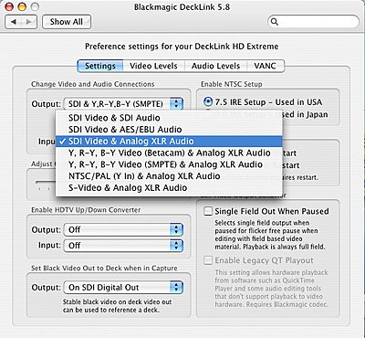

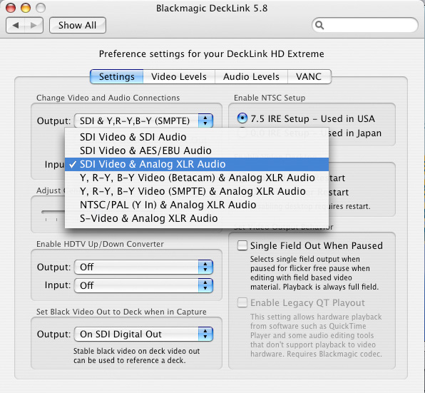

Old December 8th, 2006, 09:49 AM   #8
Location: Norway
Posts: 123
I'm on a Mac G5 and I tried that but I'm not able to choose analog audio when SDI is input.
Kristian Indrehus is offline   Reply With Quote
Old December 8th, 2006, 10:07 AM   #9
Join Date: Apr 2003
Location: Tennessee
Posts: 164
Does it look like this?
will griffith
producer/editor
Will Griffith is offline   Reply With Quote

Old December 8th, 2006, 10:20 AM   #11
Location: Norway
Posts: 123
It does NOT. I must have an old driver or something. Have to check my version. This looks promissing. Great help. Maybe there's hope after all.
(Sorry, missed your post Barry. I am of course referring to Will's post on decklink. And I agree the missing timecode is not a real problem)
Old December 8th, 2006, 10:31 AM   #12
Location: Norway
Posts: 123
My version of decklink pref settings is 5.3.7 It´s the extreme SD version by the way. I will upgrade and see what happens.
Old December 8th, 2006, 05:58 PM   #13
Location: Norway
Posts: 123
Nope. Upgraded to latest decklink driver and it looks like SDI video and analog audio capture is for HD-decklink only. There we go again. Guess it's high time I throw out the old SD card anyway.
