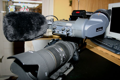

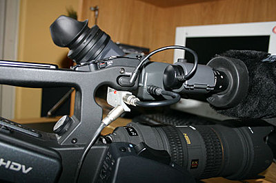

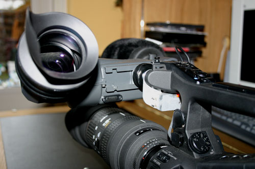

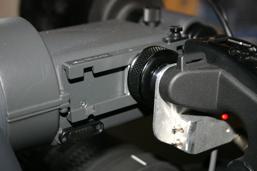

I don't try the FU 1000 because he is too small. Check out the owner of www.etkon.com , he rebuild a digibeta viewfinder for mine XL-H1. It works great. I can manage al the functions and it is a very sharp Sony viewfinder (the same as the XDcam hd 350).

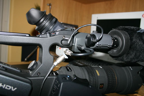

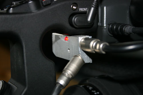

Hi All,
I will try to put some pics into my next repley next week (busy at the moment). My new viewfinders works great, but the conections are not in the final stage. He is devoloping some new connectors at the moment. The price of the VF was around 2400 euro and the rebuilding is around 750 euro (not sue about the last price because I didn't get the recieve til now).
May be you can contact his website (www.etkon.com his name is Edwin Schouten)

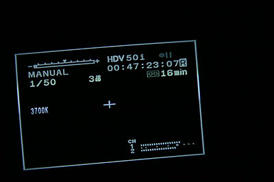

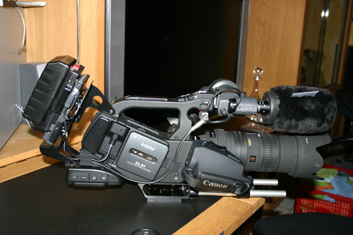

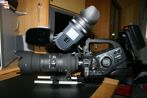

here are some pics
Hello all,
here some pictures of mine Sony Viewfinder on mine Canon XLh1.
The Viewfinder is a Sony BVF20W(ce). He is modified by Edwin schouten from the company Etkon (www.etkon.com) in Amsterdam (the Netherlands).
I am working with a 50-500 mm sigma lens for filming nature and I can tell, I can't focus with the standard Canon Viewfinder and now I can foces very good. It is worth the price dubble.
