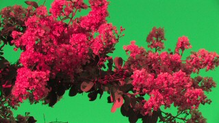

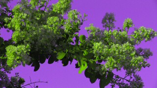

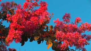

An excellent thread, and I hope this doesn't come across as being too silly, but here's some "extreme" examples of what you can do... maybe not all that useful unless you're remaking "Night of the Comet."
(No trashing that movie now, it's a sentimental favorite... one of my guilty pleasures!)

Hey Chris, I like the second frame. Very poppy and saturated like CSI:Miami.
Okay, no trashing CSI:Miami....it's one of my guilty pleasures!

Chris, which values did you use in the second image?
