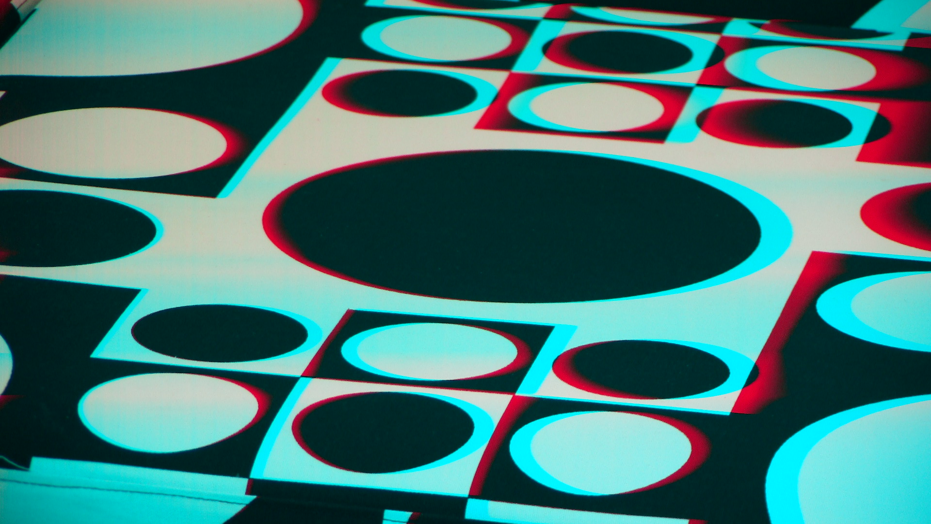

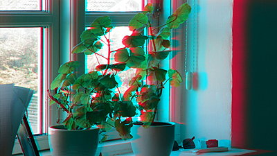

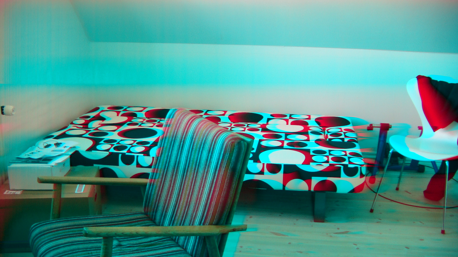

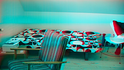

Photos from "damaged" Canon XL H1
Originally Posted by Johan Forssblad View Post
Hej Finn,
I think you have to ask a Canon service center to get a price indication for this. My friend dropped Sony cameras. If you like you could try to mail an example photo to me through this site. It could be interesting to view. However, I don't want to screw your camcorder; One pixel width out of alignment is less than 1/100 mm to correct so it is really a precision job to adjust it. /Johan
Hi Johan
Here is the photos.
The sofa you can see is totally black and white "normaly"
Regards from
Finn

The links worked fine. Nice test photo sofa you have! Looks to me your red sensor is shifted a lot horisontally compared to the green and blue. Have you asked Canon in Denmark? I'm sorry you got this bad experience. Good luck /Johan
