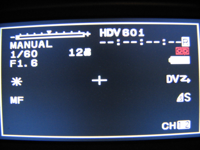

I just got a Firestore FS-C for my H1. Works great manually, but I can't find a "DV Control" or "ext control" setting in the camera's System menu. Are these somewhere else, or am I just not seeing them? (I have looked pretty carefully at the choices.)

The physical wheel on the side of the camera has an ext. control setting, but when it's set to that, I can't even get a menu on the EVF.
I have a hunch that the ext. control setting relates to using Console, and letting the software set iris, focus, etc...whatever it can set. I think the missing DV control is what lets the camera trigger recording on the FS-C.
I'd thought maybe if I kept scrolling down in the System menu, more options would appear. But there's only one screen of them. And I haven't found any indication that DV Control is a submenu item off something else.
I also made sure the Firestore was connected and running, in case the camera could sense whether there was anything to record to.
Is there somewhere on the camera I have to set it to "tapeless" first, since that's how I'm recording?

Marty, I've looked at that page of the manual several times.
Go to the System menu...that I can do!
Select "DV Control"...it just isn't in the list, or I'm not seeing it.
If someone can check the H1's System menu, what items are before and after "DV Control"? Thanks!

Posts: 27,382
When in M Manual mode... or any other shooting mode:

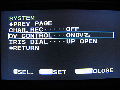

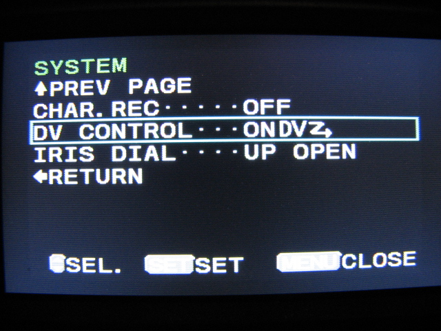

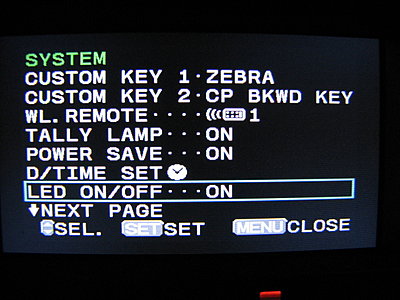

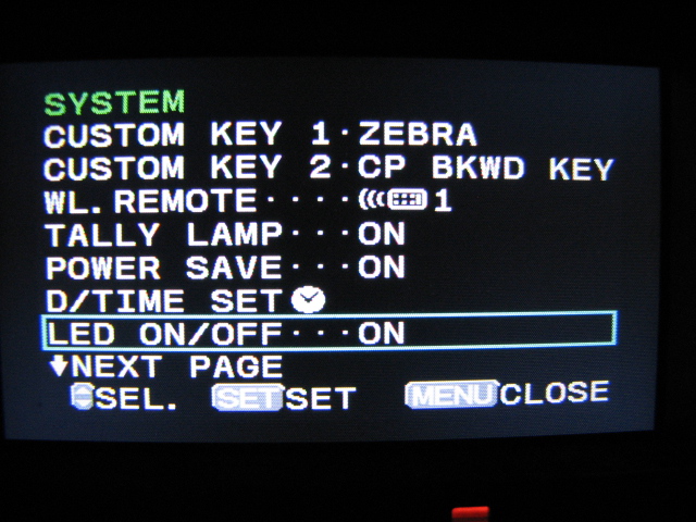

Menu > System > Next Page > DV Control > OnDV
The DV connect symbol will appear in the display, far right, below the battery guage.

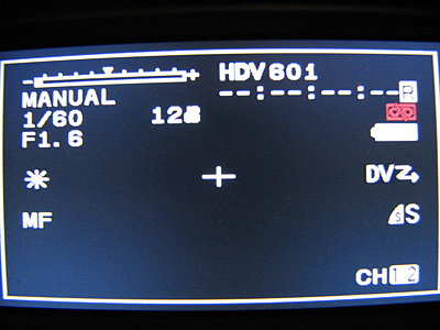

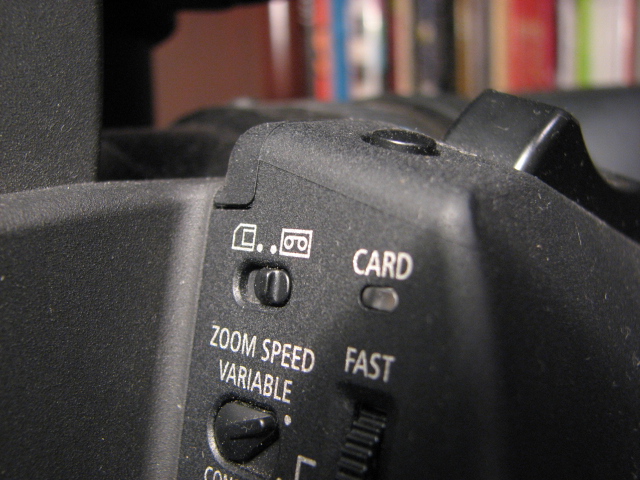

If you're not seeing the "Next Page" option in the System menu, it's because the camera is in Card recording mode. Switch it to Camera (Tape) recording mode (the little slide switch on the hand grip) -- click on attached pics for clarification. Hope this helps,

Posts: 27,382
I've edited my post above to include the pics and a solution to your problem -- scroll back up the thread to see it -- hope this helps!

Posts: 397
Chris, that totally helps!! Thank you so much! I will go and check this out right now.
If the tape/card switch setting for DV Control was mentioned in the manual, I sure didn't see it!
