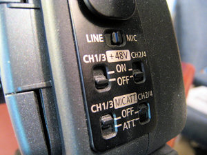

2. Can the Canon handle two line level XLR audio signals? Yes. The line / mic level switch is on the back of the camera. Hope this helps,
