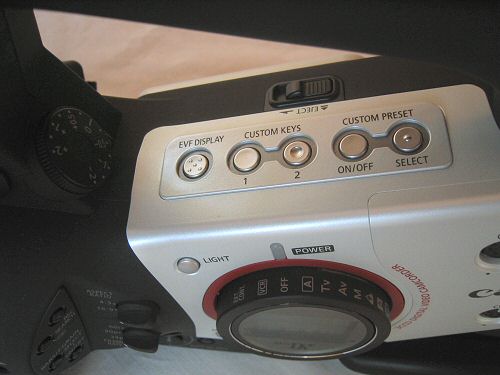

The Custom Preset Select and On / Off buttons are located on the top of the camcorder body, below the grip handle (see attached photo below). Yes you can import analog video through the line-in jacks for real-time conversion to DV over FireWire output -- no recording necessary. See your operator's manual for the specific details (should be on page 99). Hope this helps,
Custom Preset on / off-psets.jpg

I think that is a photo of an XL2.
The XL1s Custom Presets are described on Page 69 of the manual.

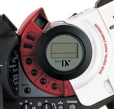

Okay, let's try this again... they're under the sliding red cover. Yeah, that's it...
