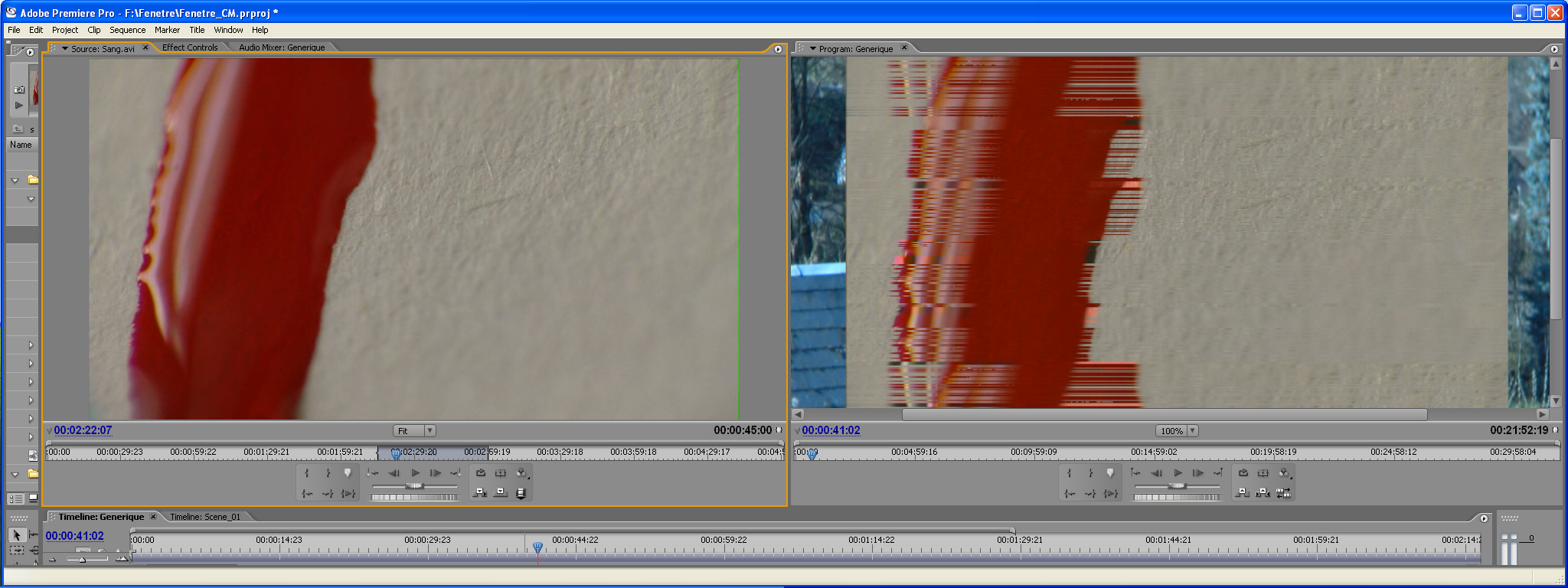

I am reopening this thread as I am facing other issues w/ playback of HDLink captured footage.
A while ago I shot footage in 60i and using HDlink I converted them to 24p (slow-motion). My project is in 24p. When importing the footage in the timeline I can't read in real-time, that's ok I guess it's normal.
When I scrub the footage the video seems fine. However after rendering and playing back I get a video with many stripes.
See attachment left side how it looks like before rendering and right after rendering?!
Anyone had this issue before?
Simon Heymans
http://www.vimeo.com/simonheymans
Simon Heymans is offline   Reply With Quote
Old August 3rd, 2007, 09:10 AM   #14
CTO, CineForm Inc.
Join Date: Jul 2003
Posts: 8,095
Contact support at cineform.com/support.
