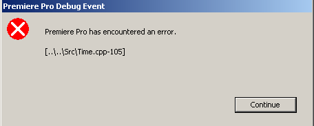

I was using the Cineform Aspect HD 2-week trial for Premiere CS3. After a week & a half I decided to un-install it. Once I did that, I'm unable to import any HD footage. So when I try to import a m2t file I get a Time.cpp-105 error:
http://www.dvinfo.net/gallery/files/...R_original.gif

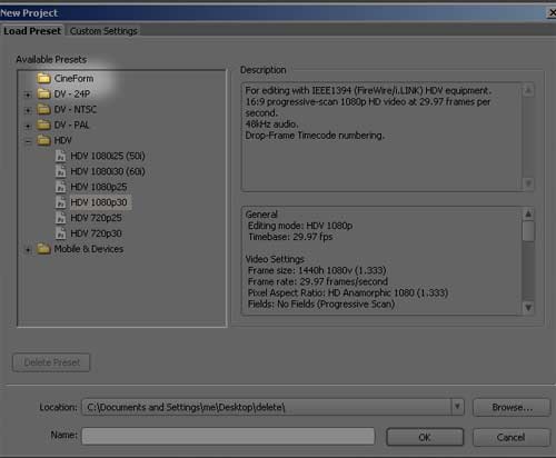

After I click OK, to not enter a serial #, there's still a option to use the Cineform settings:
http://www.dvinfo.net/gallery/files/.../1/cine-db.jpg
Has anyone else have this problem after they un-intsalled a Cineform product? Any help you could provide is MUCH appreciated, as it stands I can't work on HD footage in Premiere @ all. :(

Originally Posted by David Newman View Post
We have not heard of this issue. The time.cpp is an Adobe Error, so you may need to contact Adobe is the problem continues. Aspect HD doesn't install (or uninstall) any MPEG handling components, we are strickly AVI or MOV based. However it does seem that some component didn't completely uninstall.
Here are the directories and files that should have been removed with the uninstall.
These are the plug-ins:
C:\Program Files\Adobe\Adobe Premiere Pro CS3\Plug-ins\en_US\CineForm
The presets:
C:\Program Files\Adobe\Adobe Premiere Pro CS3\Settings\en_US\CineForm
And this file is the editing mode:
C:\Program Files\Adobe\Adobe Premiere Pro CS3\Plug-ins\en_US\Editing Modes\CineForm Editing Modes.xml
Manual direct these to clean up your folders.
Premiere is up & running PERFECT now! Thank you David!
