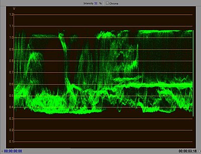

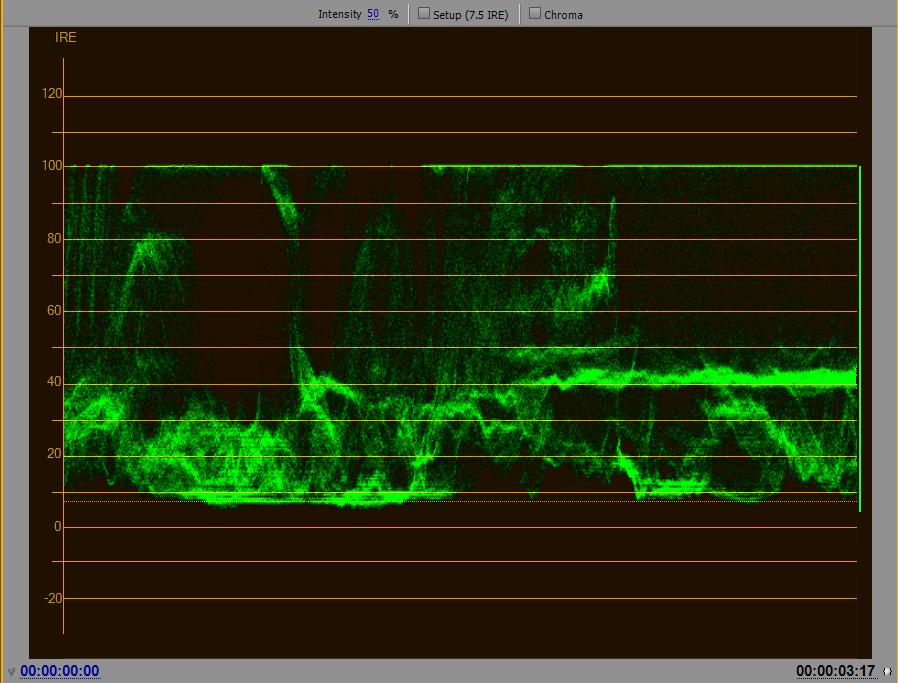

Strange going-ons with AspectHD. I'm using the latest build (90) and when I look at my clips in a Cineform project my over brights are getting clipped. The pic on the left is a frame from a regular Adobe project. The same frame on the right is from the Cineform project.
I've set Maximum Bit Depth in Video Rendering, I've got both Use HD Colorspace and Use videosystems RGB checked in the playback settings. Is there something else that I'm missing?

Likely nothing lost. The scopes prior to CS3 couldn't show over brights, nor did they tell us they now could. We refresh the scopes with cgRGB, as that was all it used to support, and cgRGB will not show above 100%. We will consider that upgrade. Note: It still seems the RGB scopes are 100% limited.
However, your highlight are not lost, as you can put on a color corrector to pull the highlights into range.
P.S. all this is much easier in Prospect HD/2K which natively supports 32-bit float for much better highlight preservation.

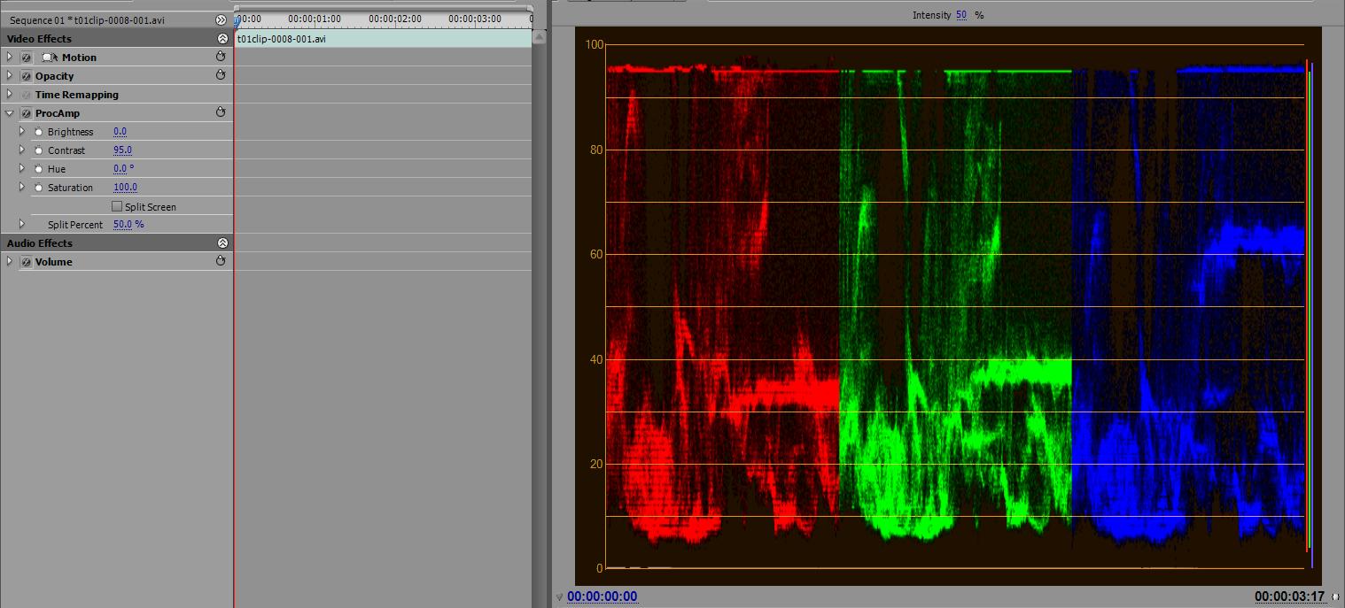

I'll usually toss a ProcAmp effect on it and lower the contrast until I've recovered as much as I could but this looks like it's actually lost the data. Are you saying that it's just a scopes issues. This could get messy.
And, yes, I'm biting the bullet and upgrading to Prospect HD next week.
