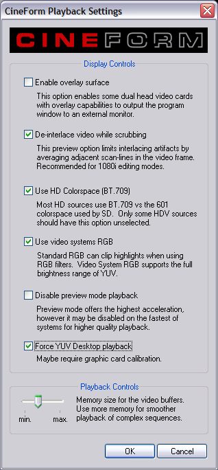

Apologies for re-opening a thread last posted a week ago but can someone tell me exactly where this "Force YUV" setting is? I cannot find it. My 'Cineform playback settings' dialpogue from Aspect HD does not have an option with that name. Only one has the term 'YUV' in it and doesn't brighten up my timeline renders :(

If you are using the latest Aspect HD is it the last entry, otherwise your not using the current version.

My apologies here. I jumped in before I had read everything didn't I? This option is a new build 95 feature isn't it? Because of other issues (build 95+ crashing Premiere) I'm forced to stick with build 92 right now. No wonder I couldn't find it!
